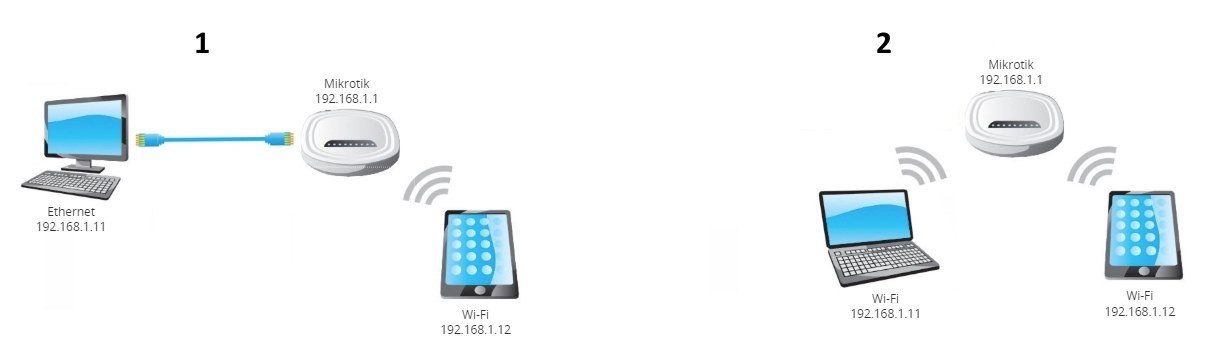

Drop forward rules NOT worked between devices connected via Wi-Fi
Example. My Mikrotik-router Model 951Ui-2HnD
RouterOS v6.43.8 (stable) (192.168.1.1)
with Firewall rules (IP > Firewall > Filter Rules):
add action=drop chain=forward dst-address=192.168.1.11 src-address=192.168.1.12
add action=drop chain=forward dst-address=192.168.1.12 src-address=192.168.1.11
Interface settings.
/interface bridge settings
set allow-fast-path=no use-ip-firewall=yes use-ip-firewall-for-pppoe=yes \
   use-ip-firewall-for-vlan=yes
/interface wireless
set [ find default-name=wlan1 ] mode=ap-bridge
First (expected) situation:
Notebook (192.168.1.11) connected to Mikrotik via Ethernet.
Tablet (192.168.1.12) connected to Mikrotik via Wi-Fi.
If we send ping packages from Notebook to Tablet they are drops, as should be according Firewall rules.
Second (not expected) situation:
Notebook (192.168.1.11) connected to Mikrotik via Wi-Fi.
In this case, if we send ping packages from Notebook to Tablet we got it back. Firewall rules not applied.
No traffic if you watch traffic through: Tools - > Torch.
No icmp packets between Tablet and Notebook if use Second situation.
What’s wrong and what to do to fix it for work rules Firewall and was in sight packages in Tools - > Torch?
+Attached picture below.

Your config is wrong.
Your second “unexpected” condition is correct and is totally expected for me.
The traffic doesn’t even enter the bridge - it remains in the wireless interface, the two devices use your wlan interface as a wireless switch.
Mitigation would be disabling default-forward on the AP - this will isolate clients connected to the same wireless interface.
-Chris
OP set default-forwarding=no on wireless interface already. However, manual says that
This is the value of forwarding for clients that do not match any entry in the access-list
. OP has access-list constructed and there’s again “forwarding=” with default value of “yes”.
The problem might be then the following: does bridge send packets back to the ingress port? If forwarding was set to no, then all packets from wireless client 1 would be sent to bridge. Even if bridge rules would allow those packets to be delivered to wireless client 2, do those packets get sent back to wifi “port”?
Sorry, didn’t notice the default-fwd=no in the config.
As OP also set default-authentication=no and created an access list with default-forward=yes per client, this setting overrides the setting in the interface setting.
So we’re still talking about a default-forward issue on the w/l interface.
-Chris
I found a possible problem. in settings Wireless → Access_List are the leaf access. Where indicated in the hand value of the Forwarding = Yes. if you remove the check mark (Forwarding = No), then everything is fine, the data exchange stops. Seems the problem solved.
