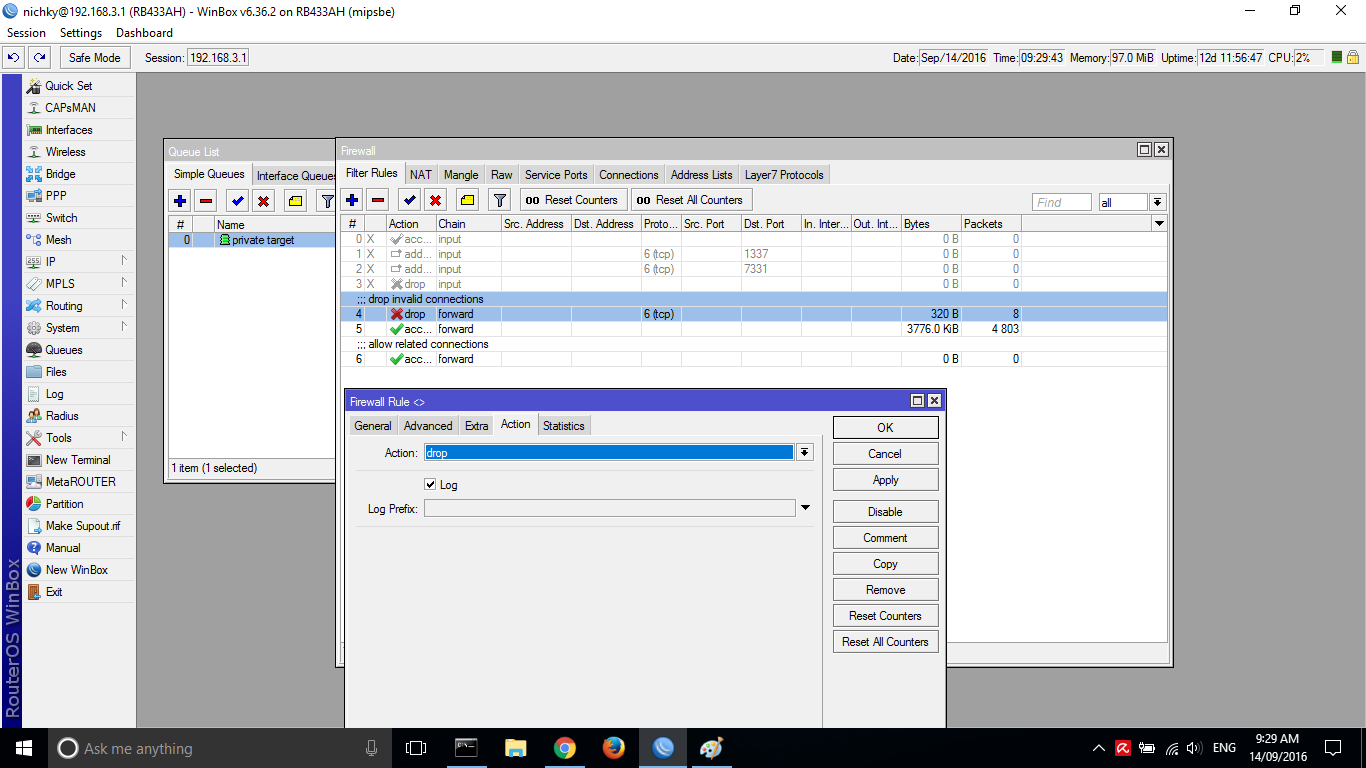

I’m interested how can i see Drop Package on MikroTik. Does anyone know any rules on firewall. It will be helpful. I’m using the rouls, but i’m not sure does it connect.

you can enabling logging on your default drop rule to see what what is being dropped.
Would you like to be more clear, i have understand you, but i have idea how to do rules.My one is incorrect?
just add “log=yes” to your drop rules.

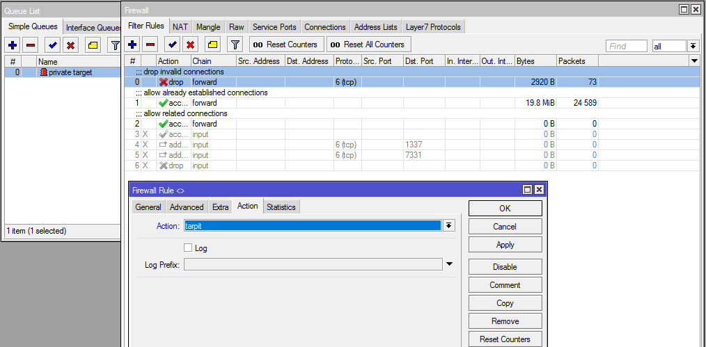

Doesn’t matter enable log or not log the package is going on,see picture

If you enable log you can see drop packet related log in mikrotik log manu .
And I don’t understand what you mean by "the package is going on "
Be more sapcific so staff or other user can help you .

Elittebb : He was tarpitting the packets, and you wrote “be more SAPcific” … Gave me the best laugh of the week… :laughing:
Nitchky: As elitebb wrote. You do not see the logs in the firewall rule in winbox. You can view them in the “LOG” section of the main menu in winbox. if you are loggin a lot of items, you can put a Log Prefix in the firewall rule to make them easier to find in the log. For example, you could put the log prefix "DROP INVALID CONNECTION /// "
