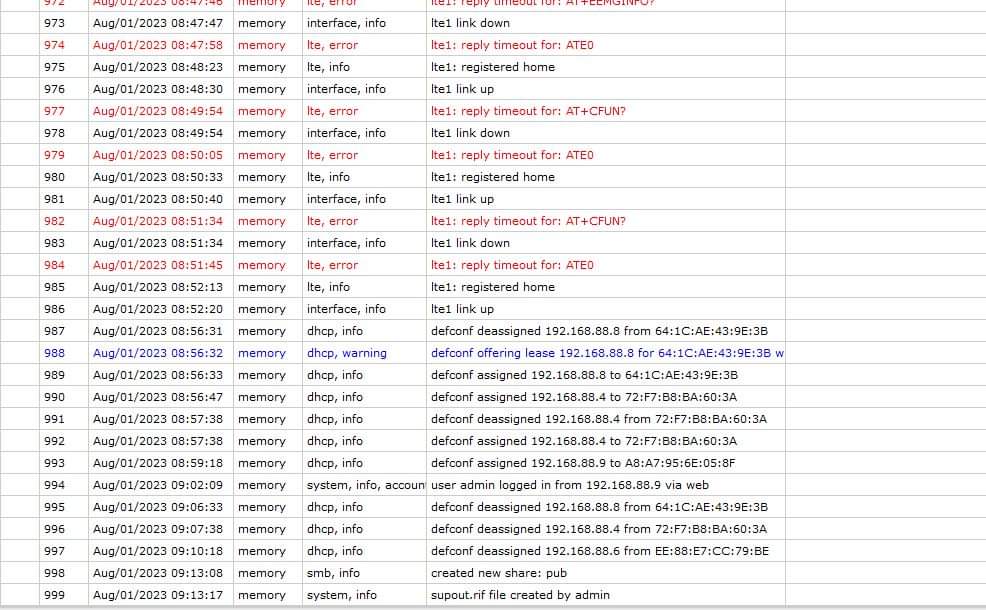

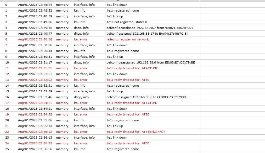

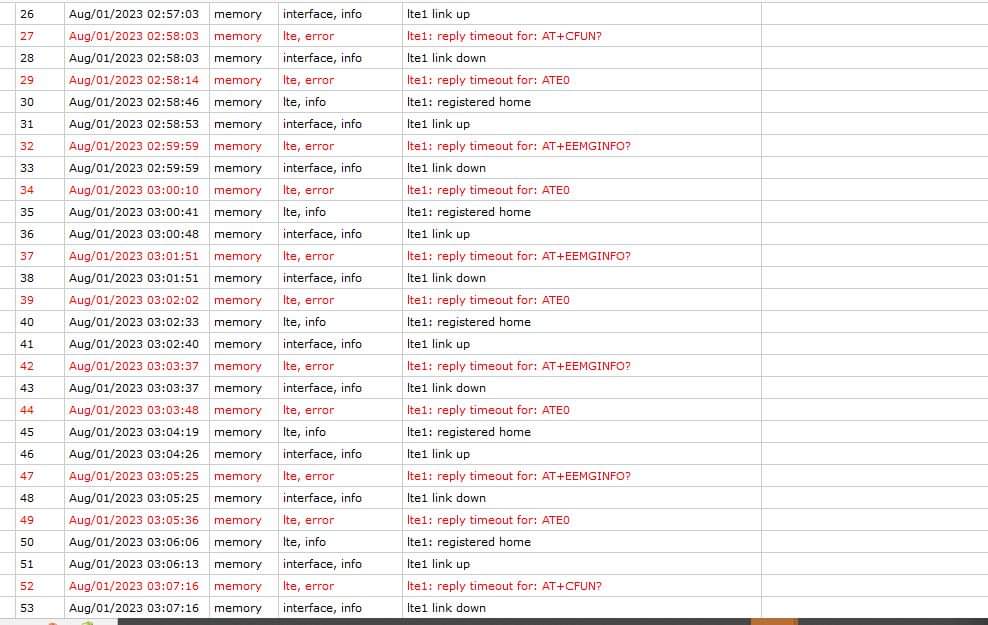

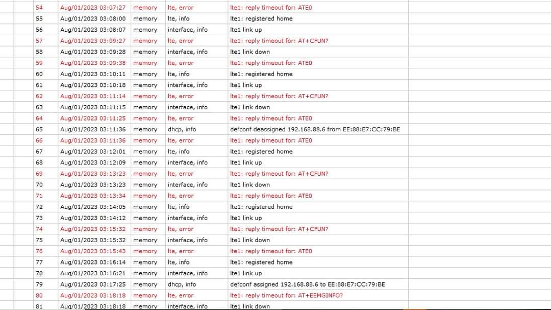

Ive got a MikroTik RBSXTR&R11e-LTE6 I’ve used a lot of these but this one is causing issues.
It has a uk EE wim installed, apart from APN and DHCP POOL its config is default. It worked fine for a number of days now keeps dropping the LTE connection, this happens after a few hours of working. I can get it online again by rebooting.
I attached some log images.
Any ideas?
Thanks all

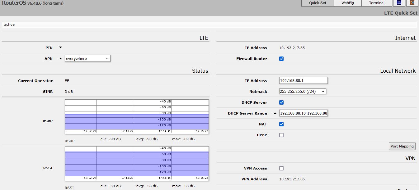

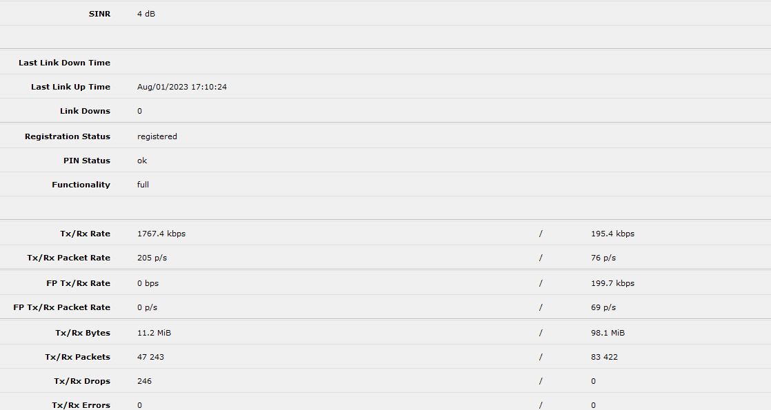

Signal strength? ROS version? Upgraded LTE firmware?

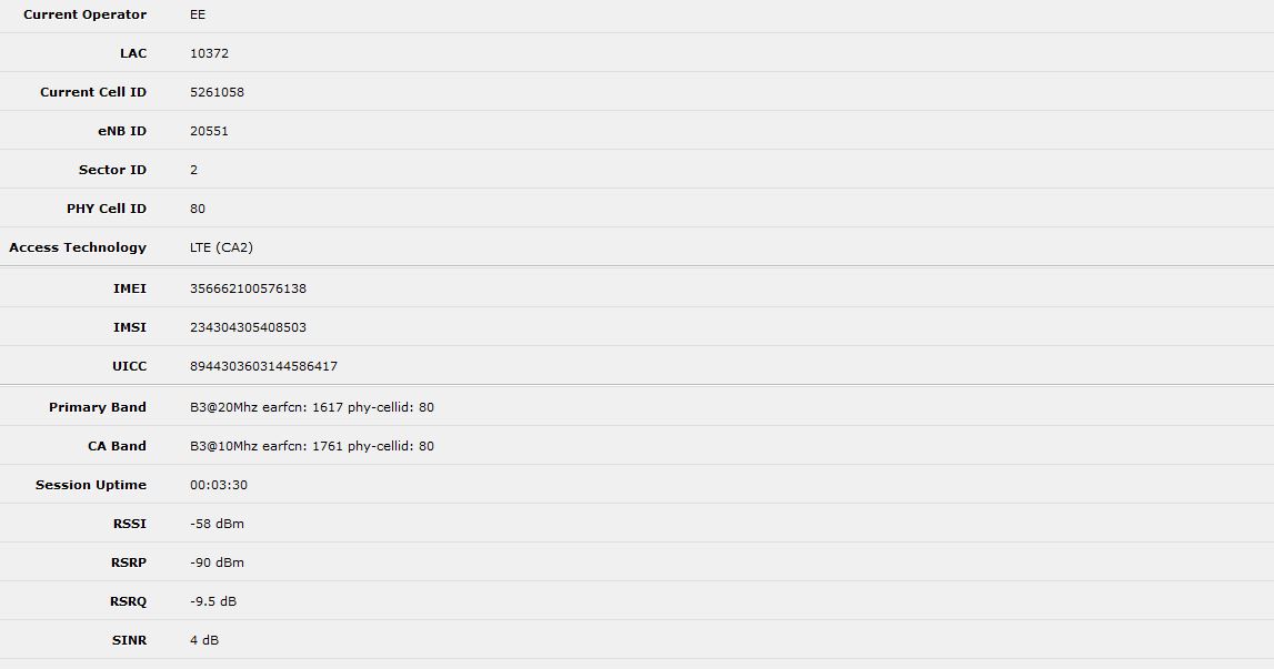

Sorry, not on site have got the lamds to send the following images.
