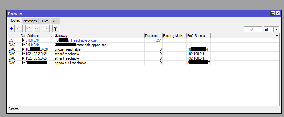

Make an export of IP->Routes
Hope this helps, really appreciate your help with this

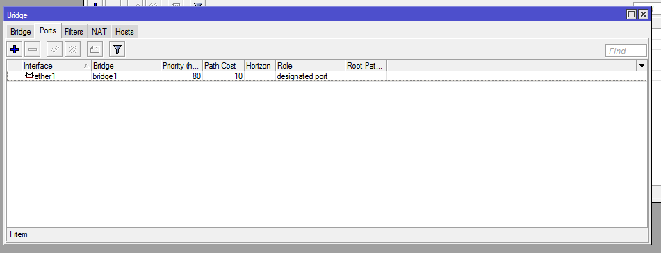

Which ports you have in Bridge?
Just our WAN Port on ether1 interface
Why you have a Bridge only with Ether1?
Put the IP Address of the Bridge on Ether1 and remove the Bridge.
