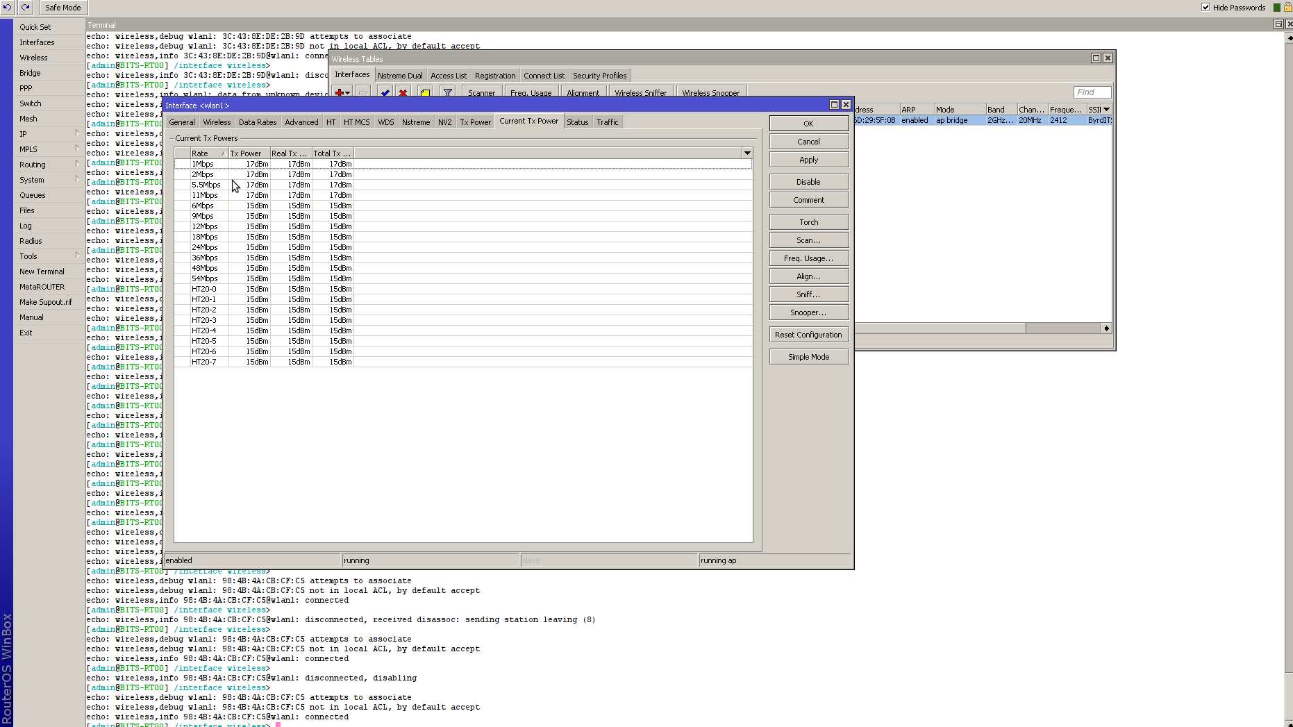

this is a single soho router setup. ether1 is wan, 2 is lan with dhcp, wlan1 is wireless. very basic. signal strength doesn’t matter. i was 6 feet from the router troubleshooting when i got that ping response i posted.
this is the only thing I can find in the log that isn’t normal auth/deauth
echo: wireless,info C8:AA:21:40:02:C5@wlan1: disconnected, group key exchange timeout
I set the group key update to 1 hour. It seems to have stabilized. But I’m assuming at the 1 hour point, whatever is screwed up with knock all wireless clients off.
Try dropping the power down to circa 23db , by default its 30db which is way to high.
Also, just for a test, try without using WPA/WPA2 and see if the ping response stabilises.

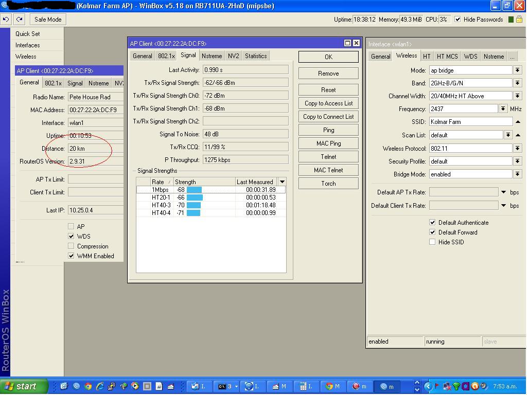

Yesterday I installed a RB/711UA-2HnD and it sounds like I had the same problem with the group-key fault in the log file.
The signal strengths are in the -60’s. 5 x Clients, all of the TX rates were 1Mbps but the Rx rates are 180Mbps etc.
I used an M2 Loco to connected and I had a lot of trouble getting it to connect. In the end I changed the security on the M2 Loco to WPA2 only, with out the TKIP as it had chosen when I scanned and selected as I have normally done over the years.
The interesting thing was it thought the radio was 42km away, but is only 1.2km. It did show 1.2km when first booted up, but the AP faults very quickly.
I spent a couple of hours wasting my time upgrading to latest OS 5.18 and upgrade firmware.
I do not have remote access, so when I return, I will take RB411U and R52Hn to replace as I can not afford to spend my time fault finding something silly like this fault.
The only thing I have not done is a system reset and reconfigure.

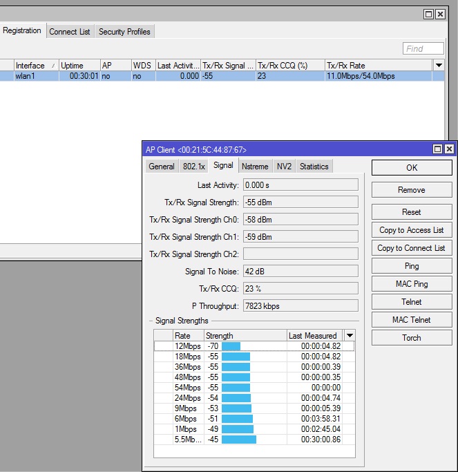

I have the same problem Matt does with my 751u-2hnd. It’s an intermittent problem where the TX rates will drop to abysmal levels, (1-10mbps) stay there for some period of time (Between 1 and 10 minutes) then eventually rise back to normal rates.
It happens with all clients, on any combination of settings. I’ve tried WPA, WPA2, WEP, different channels/width, different antennae chains, WMM on/off, advanced/legacy rate selection and b/g/n | n-only | g-only | b-only. Nothing alleviates the problem.
It seems to me that it’s a problem with the rate selection, as during the problem the signal strength and/or error rate never changes. Strangely, my AP also thinks the clients are over 1km away, even when they’re in the same room.

No ones still posted their signal strength and tx power outputs.
The link distance is 1.2km
Registration Signal says it is 20kms.
Signal strength -62/-66
Tx 2Mbps / Rx 180Mbps
Signal to Noise 48dB
CCQ 10/99%
P Throughput 530kbps
Here is an export compact:

Here is a visual:
Likewise. I have also sent this file to support along with my supout.
I removed encryption. I will change the power output once I get home and try it again and I will let you know the outcome.
here’s the current power tx
tx power mode is card rates and it’s at 30 right now. doesn’t seem to change the actual output. i must be missing something.
Be sure to disable TKIP in your WPA/WPA2 profiles.
Also try changing TX Power by using the “card rates” option to say 17dbm
I have found that being to close to the AP with high power does not work well.
