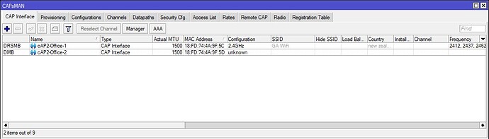

Dropping wireless connection hEX PoE RB960PG S and Cap AC,
Greeting to all,
I have a RPI 4 which drops out of the wireless contact at random. Sometimes it reconnects other times not. Sometimes it seems to freeze. I could not find any errors on the RPI server.

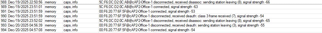

I have looked at the logs of the wireless access point.
Would anyone of you be able to give a hint what could be wrong?
TIA

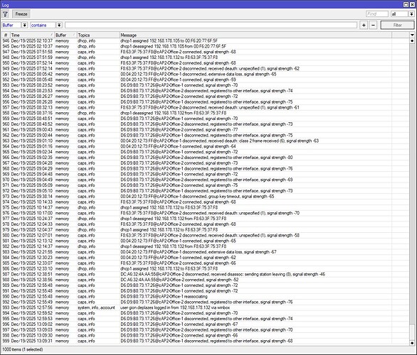

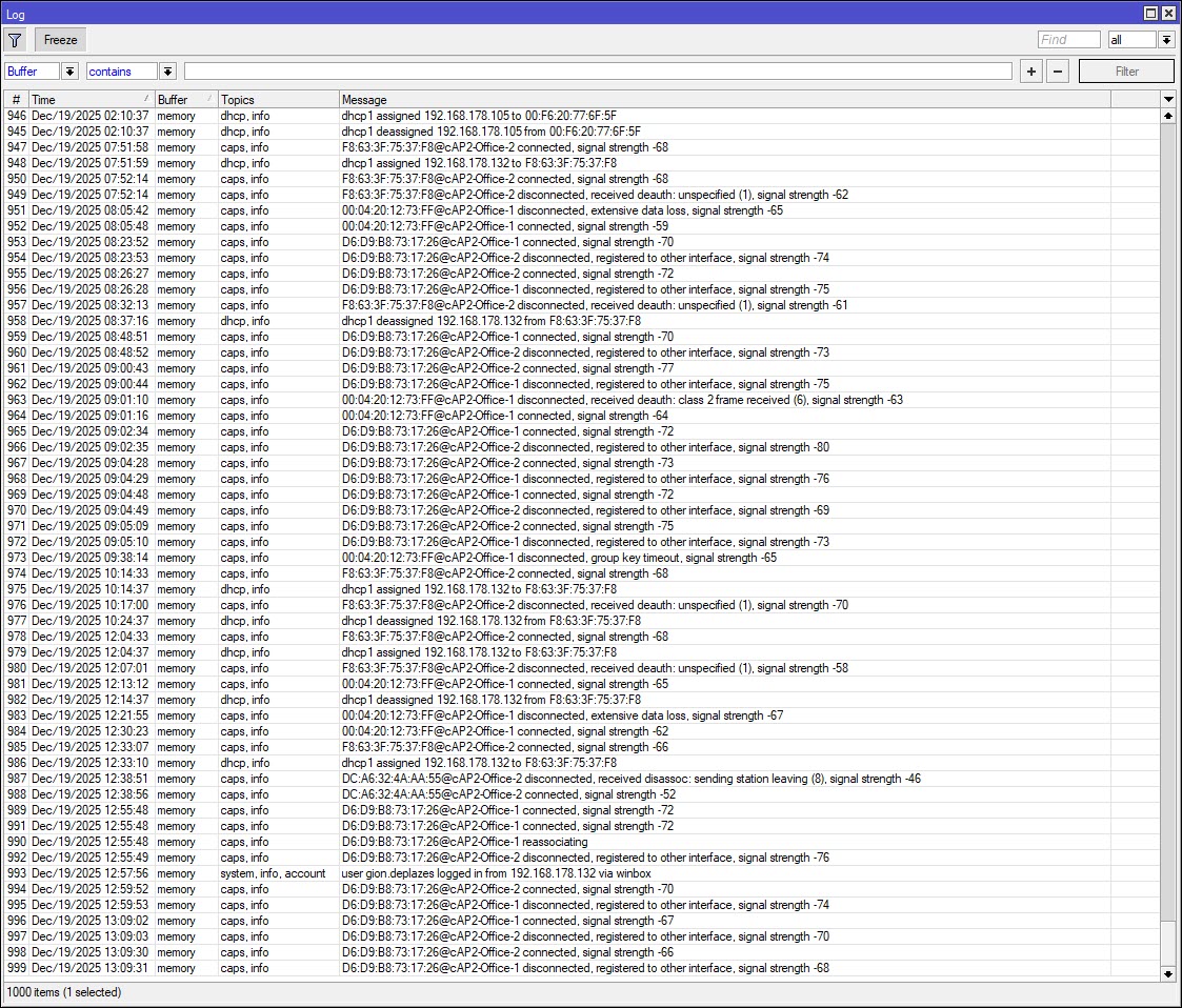

It seems that RPI switches between different WiFi radios a lot. And it seems it's not using the mobility enhancements, logs are saying "disconnected, registered to other interface" ... when device uses mobility enhancement functions, log says "roamed to".
And many of those AP switches don't seem to make much sense as signal strength before and after is nearly the same ... the only sensible explanation would be that device is switching from 2.4GHz to 5GHz (but the reverse direction doesn't make much sense).
In any case (mobility enhancements or not), it's always station's decision to switch/roam to another AP. So troubleshooting should focus on station (AP's logs can help but they won't tell the whole story).
