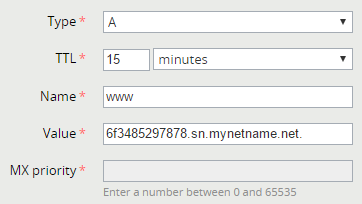

The type of DNS record you are after is a CNAME. Make the record for your web-site say, www.bestwebsiteever.com, be a CNAME for your ddns name. If you are using the built-in MikroTik ddns service then a simple “/ip cloud print” will show the name you need to enter as the CNAME record target.
Here is a snip from a provider I commonly use (Gandi) for public DNS referencing a name like you would get from the built-in ddns service:
