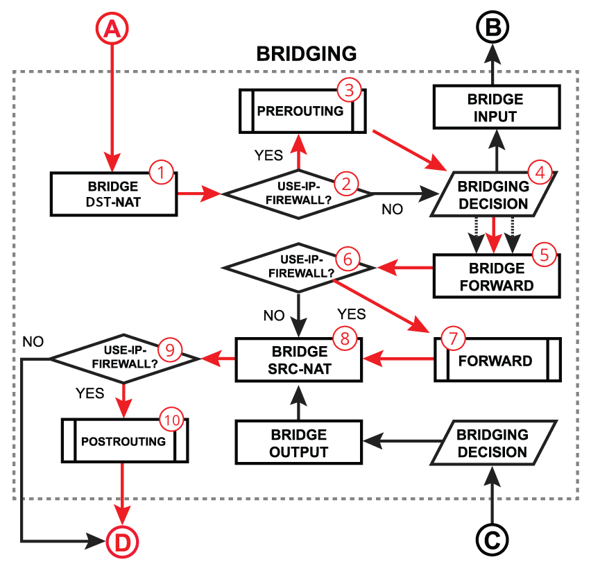

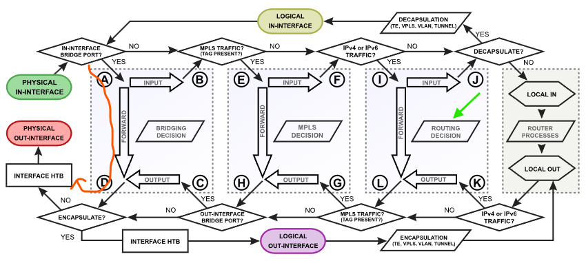

Ok, then use-ip-firewall=yes is not the right solution for your needs. When you turn that on without doing additional bridge DSTNAT and bridge SRCNAT, your IP firewall NAT rules will not be able to do what you want. See: Packet Flow in RouterOS | RouterOS Manual.
Because the destination MAC address is not changed, even after going through the IP firewall with its NAT rules, the ethernet frames will still follow the path of this orange arrow, and will not touch the routing decision needed to direct the packets to other networks (green arrow)
The Bridging Decision part at number 4 in this diagram:
only cares about the destination MAC address, and that MAC address has not changed (still being the MAC address of the 192.168.100.200 host). Which means the decision is to forward the frame to that host, even though your IP firewall DSTNAT rules have modified the destination IP address of the packets. use-ip-firewall might easily help you implement firewall filter rules that drop packets, but when NAT is involved, it's no longer straightforward!
