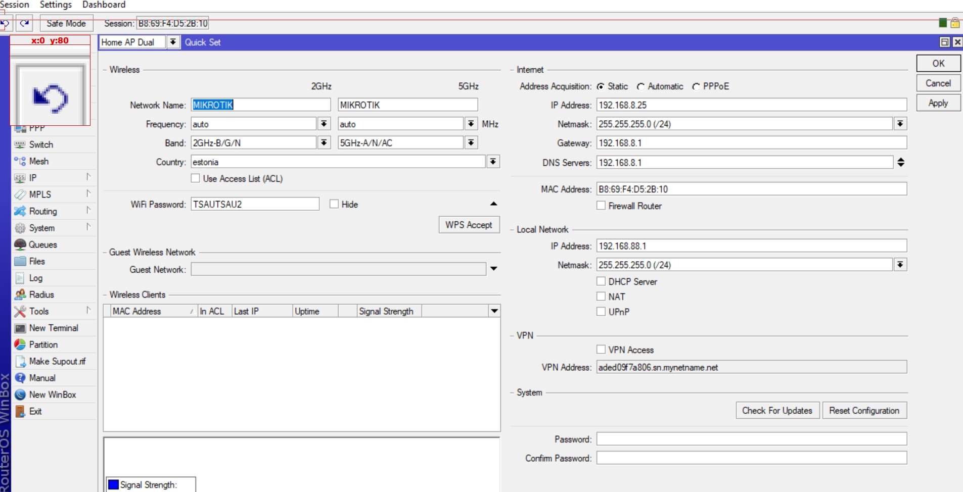

Hi all! Please help me quick setup Home AP dual. My router address/gateway is 192.168.8.1, mask 255.255.255.0. In router are enabled dhcp. If I connect Mikrotik cap to my switch, it must work as AP and share 2,4 and 5 GHz wifi in other side of my house. I add one screenshot, please give me any tips what I do wrong. I see from my pc this Mikrotik, can connect through wifi, but no internet access.. Thanks for any help!

@okaru: Unfortunately, this can’t be done with Quickset. The closest setting to your need would be “WISP AP” in “bridged” mode, but then you still have to manually set wlan1 (2GHz) because “WISP AP” mode sets only wlan2 (5GHz)
@anav: You don’t need to see whole config. We actually talked about this a while ago: http://forum.mikrotik.com/t/using-mikrotik-hap-as-simple-switch-plus-wireless-ap/107237/14 Until Mikrotik change their quickset for home-ap and home-ap-dual to have “bridge/router” switch, then this has to go through full setting. (which seems easy to us, but for new users it is terrifying)
simple explanation of what is happening according of screenshot:
  • “home AP dual” quickset → router mode with Eth1 = WAN (“internet” section in quickset) vs ETH2-5 + WLAN1-2 bridged (“local network” and “wireless” section in quickset)
  • “firewall router” unchecked → there are no firewall rules. Literary NO firewall rules → everything is accepted, no questions asked. input, forward, … you say it…
  • “dhcp server” unchecked → connected devices won’t get IP.
  • “NAT” unchecked → there is no NAT rule (src masquerade) this is the thing which makes it confusing for beginners By default it is unchecked and such quickset will not work in any typical environment.
To sum up - if @okaru enable checkboxes DHCP Server and NAT, internet will magically start working on wifi and Ethernet ports, but that won’t be true “AP/bridge” mode. It will be just “router” mode which is not recommended for this purpose. (because of extra NAT)
I would strongly recommend mikrotik to add a “router / bridge” switch into “Home AP” and “Home AP Dual” quicksets, same way as they did it in “WISP AP” quickset. In addition, if “router” mode is selected, it would be good to have a “Firewall Router”, “DHCP Server” and “NAT” checkboxes enabled by default.
At the moment, devices usually come with reasonably good factory setting. However, quickset (which should make setting quick and easy) actually breaks this good setting by default and users must make extra effort to correct it.

Yes, that is what I recommended to OP - use WISP AP in bridge mode and add manually remaining WLANs. Unfortunately, that will require to step out of quickset.
