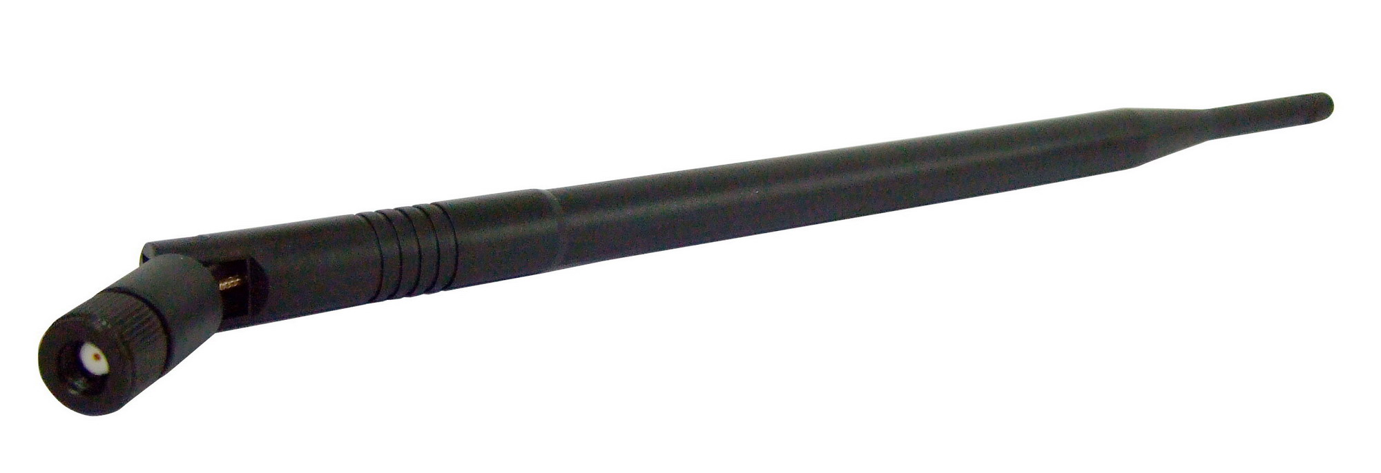

  2. what aerials would people advise using for an office environment

also, i’d avoid using extra pigtails, get any RP-SMA compatible antenna and attach it directly to the connector.
you should end-up with Basebox 5 with two antennas attached, one for 2GHz(Single chain) and other for 5GHz(Single chain).
