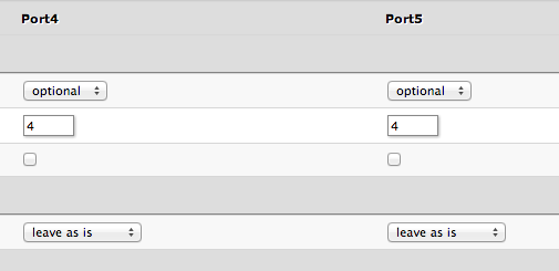

As far as i know you can do that when setting the ports on Optional (and leave the header ‘as-is’).
Then you put the ports on vlan4 and packets for vlan9 will travel thru it.
Like this:
Doesn’t work as it leaves the traffic tagged with Vlan4 which is what causes problems for the connected device.
