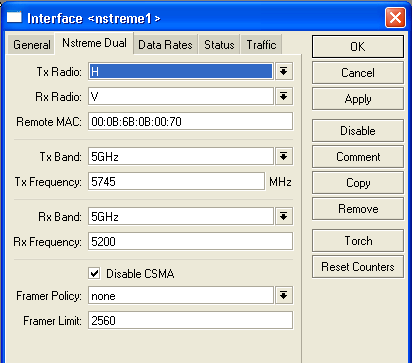

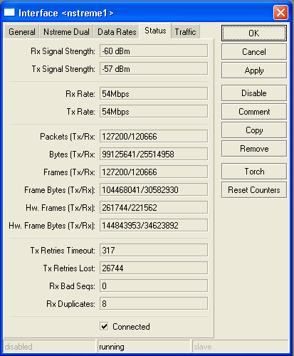

I have started to try Dual Nstreme again. What Im seeing is a lot of tx-retries-lost. Im not sure as to what is going on so any information would be appriciated. The following is a screen shot taken of the Master router about 5 min after I reset the counters.

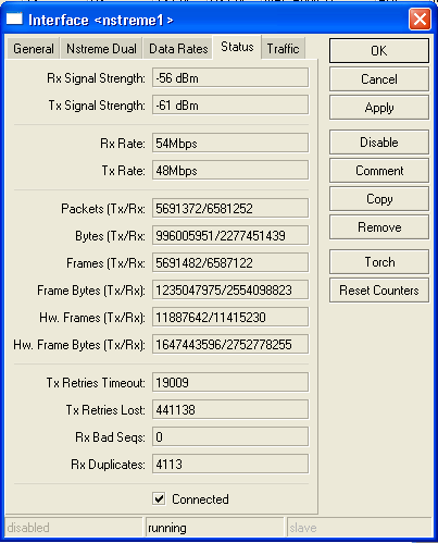

The next screen shot is Slave router that has been running about 8 hours and no reset of the counters.
I ran both freq in non Nstreme mode for a while and didnt see any interference and quality of the signals were in the 90’s. Im just not sure what is going on or even if this is normal. Any thoughts

I run a short duel nstreme link. I’m not sure what is an optimal stat. I’m assuming dividing retransmits by total transmits will give you a retransmit rate. Looks like your running about 20pct retransmit rate. I have a short link (about 1/2 mile) but has a tree smack in the way and I run about 33pct retransmit. I know the obstruction is hurting me. Oddly my signal is still in the low 60’s. Since we don’t really get a CCQ reading AFAICS, what do you guys think a decent retransmit rate in duel-nstreme would be? 10pct?
