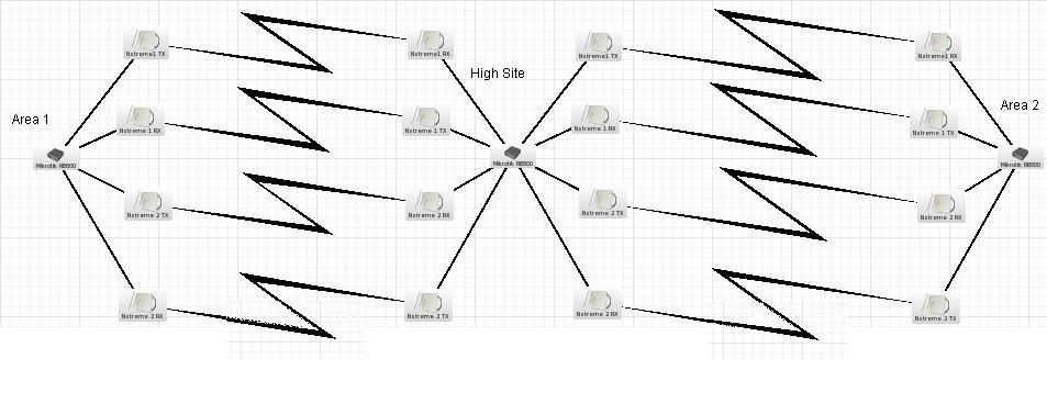

Has anybody run 2 Dual Nstremes in Parallel?
I need to put up a high speed link between 2 points, I am looking at using 3 RB600 and 1 daughter board and 16 panel antenas, there will be 1 High sight as I have a ridge in the way.
or any suggestions?

I have done a drawing of what I was talking about. If anybody can help, please post a reply.
What thruput you need ?
Viking.za
i’m doing almost the same topology with two dual nstreme… as i guesed you want to agregate links for maximum thruput..
when i did this using routing i coudn’t double the thruput…
but now i’m going to configure vpls tranparent bridges per wireless link and bonding feature on rb1100(bond 4 interface)..maby it will work…
