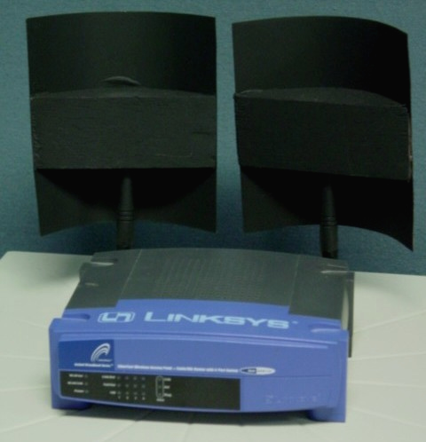

The spacing between antenna element and metal shield becomes a “Reflector Element” if set to a frequency wavelength (1/4 or 1/2 Wavelength ) this could help to amplify the forward gain of the signal coming from the antenna, like in the picture DIY booster used for wi-fi, where there is curve on the shield to achieve this?
