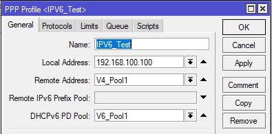

In my test setup, I am getting /48 IPV6 address from Tunnelbrocker, and works as intended. The setup works well on both Windows and Android phones. Now I try to setup dual stack PPPoE server on same Mikrotik and same IP pool. I derive a /50 as IPV6 pool. I follow the https://wiki.mikrotik.com/wiki/Manual:IPv6_PD_over_PPP tutorial. The setup works as intended. The only problem I am facing is, IPV6 not routing. I am getting no route to host error from both Windows and Asus Router.

I also think that is the problem. How can I solve the problem.
Also what is the difference in remote IPV6 prefix pool and DHCPV6 PD pool and which one is good.
I’m no IPv6 expert, so the following is only a speculation on my side, others may correct me: the DHCPv6 PD pool tells the Tik from where to delegate the prefixes via DHCPv6, whereas the remote IPv6 prefix pool is the one from which it assigns IPv6 addresses to the PPPoE clients themselves (i.e. to the interfaces representing the PPPoE tunnel at their end) via PPP, not via DHCPv6. So the fact that you have indicated nothing as remote IPv6 prefix pool may explain why the Asus is unhappy, although, as said, it actually should not need the address at all - a link-local one, which is added automatically, should be sufficient.
And wait, I may have misread your OP - when you write that you get “no route to host” from Asus and Windows, did you actually have in mind that you get this on the Mikrotik when you ping from there the Asus and the Windows? Because if so, you don’t get the “no route to host” from these devices but from the Mikrotik itself, and the reason is really the absence of the remote-ipv6-prefix-pool in th e /ppp profile. As you can read in the manual, the Mikrotik itself needs to know the remote address (of the Asus) to dynamically create a route to the subnets delegated using DHCPv6 via that address:
remote-ipv6-prefix-pool Assign prefix from IPv6 pool to the client and install corresponding IPv6 route.
Thanks for your reply. I tried with enabling both remote-ipv6-prefix-pool and DHCPv6 PD pool. Then Windows will get two IPV6 addresses. But still problem persist.
