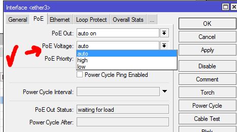

well ill have one of these units here in a day or two, and will test exactly what my question/reply above states. Ill update here when i know.

great news / great solution to this question that ive been having for over 6 months (ever since that first announcement PDF mt news-letter)! it looks like you CAN run a 24v passive device AND a 48v active poe device from these crs112-8p MTs at the same time!
there is exactly what i was hoping for, an option in winbox → eth → poe tab , where you can set PoE voltage = High/Low. (see img)
ofcourse you need to provide the MT with 24v and 48v psus at the same time, but this is great news / great use case for these units!
I have read the PDF manual and sales pages, and every forum post i could find on this unit, and none of them 100% clearly (IMO) state that this is possible, they do hint at it, but to me, it was not 100% clear that you could simultaneously do this. so great news!

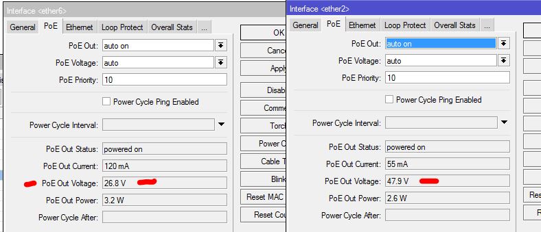

auto works great as expected too, 1st device is a MT hap ac lite // 2nd device is a poe AF ap from another mfg:
