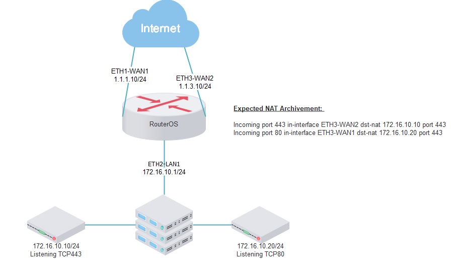

Hi all,
I am just a server guy and have limited knowledge of networking stuff, feel embarrass to ask this question lol because the Mikrotik router I am using was a gift from a friend…
Recently my ISP upgrade my subscription and gave me totally 4 IP addresses, I have connected the additional one on ETH3-WAN2 by DHCP client. I can see RouterOS generates 2 default routes for me (I don’t know what the route means anyway…)
I set the connection up because I have some servers in my LAN. I would like to have ETH3-WAN2 accept some tcp connection, say port 443 and DST-NAT to my nginx inside. I found 2 issues.
  1. ETH3-WAN2 IP is not pingable from outside
  2. It looks like that it has not accepting any connection at all so the DST-NAT rules does not do anything. I get time out when connecting to ETH2-WAN2 IP from outside, say browser https://1.1.3.10
I have gone through the forum and knows about the terms Mangling, I used to follow some rules and none of it works, i.e. still not pingable, still cannot connect to the WAN2 IP.
Attached is the network diagram. I would like to seek help from expert like you here, and I would like to say sorry if I do not understand your explanation. Please slowly guide me through to provide any information you need about my router current config.
Thanks!

The goal is clear (and nothing unusual). What is not clear is what exactly you mean by
Because there is a difference between “the rule doesn’t even count packets/bytes”, which means that no packets are coming in, and “the rule appears to do nothing because no responses come back to the client”. The thing is that dst-nat rules are processed before an filter rules, but after raw rules which can drop packets as well.
So try to read this, starting from the last paragraph (starting with EDIT) which explains the relationship to your case. What is missing in that post, because it has been mentioned in one of the previous ones in that thread, is that it is not enough to assign a routing-mark but a set of routes with that routing-mark must exist. For your simple case, the routing-mark may be assigned using /ip route rule rather than /ip firewall mangle, but the marked route via the proper gateway is the key.
If it doesn’t help, follow the suggestion in my automatic signature below, to get back a set of configuration lines to copy-paste.
Thank you very much for your reply Sindy, I am sure I will spend my time to follow the posts u gave.
DST-NAT rule doesn’t do anything - meaning that in the sense of troubleshooting, I try to connect to the server from browser externally and see if the NAT rules kicks in due to the IP is not pingable externally. There is no packet going through the NAT rule and eventually browser responses connection refused.. Since my network knowledge is very limited I am not able to judge where the problem is, either the WAN port configuration, or the nat rules.
I am going to ask the more obvious! Are you using the default firewall? And did you add ETH3-WAN2 to WAN Interface List?
OK, this is an important piece of information. Unless you have something in /ip firewall raw, the fact that the dst-nat rule doesn’t even count packets suggests that the packets didn’t make it to the router from outside. To be sure, run /tool sniffer quick interface=ETH3-WAN2 and try to connect from outside to the IP assigned to ETH3-WAN2. If you know from what address you’ll be connecting, even better, as you can add ip-address=that.known.ip.address to the command above, to get rid of any eventual noise.
You must not test from anything connected to that same Mikrotik, as in that case, the traffic would not come in via ETH3 but would take a shortcut!

Since both your public IPs are assigned dynamically using DHCP, they are not shown in export. The export command shows the static configuration; a print command shows the currently existing items, including those dynamically added. I don’t ask for a print output, it’s just an explanation.
@mutluit is right that your firewall is not tight enough - you use a mix of “permit everything but a few exceptions” and “deny everything but a few exceptions”, but the first one wins.
I personally prefer to deny everything but a few exceptions, because if you forget to permit something that should have been permitted, your legal users will be unhappy and will let you know quickly; if you forget to deny something that should have been denied, your illegal users will be happy and will never let you know.
But that’s a subject for another topic, although a very important one if you want to remain the only administrator of your router.
To the topic of your OP - from what you wrote I understand that the IP addresses you get from the ISP are fixed despite the fact that you get them using DHCP, can you confirm that? The difference it makes is whether it is necessary to add a script to the DHCP client configuration, which would update the gateway parameter of a route via ETH3-WAN2, or whether it can be left out because the IP address of the gateway actually never changes.
Given that you actually port-forward the traffic which arrives to ETH3-WAN2 to multiple internal addresses, use of /ip firewall mangle to handle the assignment of the routing-mark seems more appropriate to me than use of /ip route rule. Nevertheless, the /ip route rule rows are used to prevent packets coming in via WAN2 from being routed back through it instead of being delivered to the LAN hosts - it’s one of possible ways to ensure that.
So the following will make all connections which come from the internet to the public IP assigned to ETH3-WAN2 be responded through that interface:
add dst-address=0.0.0.0/0 routing-mark=via-wan2 gateway=[/ip dhcp-client get [find interface=ETH3-WAN2] gateway]
