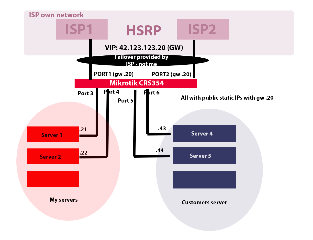

Like below. I will have max 3 servers, customer will have 5.

From your picture the previous suggestion of ethernet port isolation should provide what you are looking for, although i’m not sure why you would want to prevent five or so other servers accessing yours when the entire rest of the internet can.
