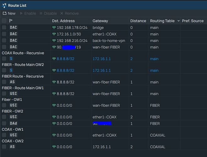

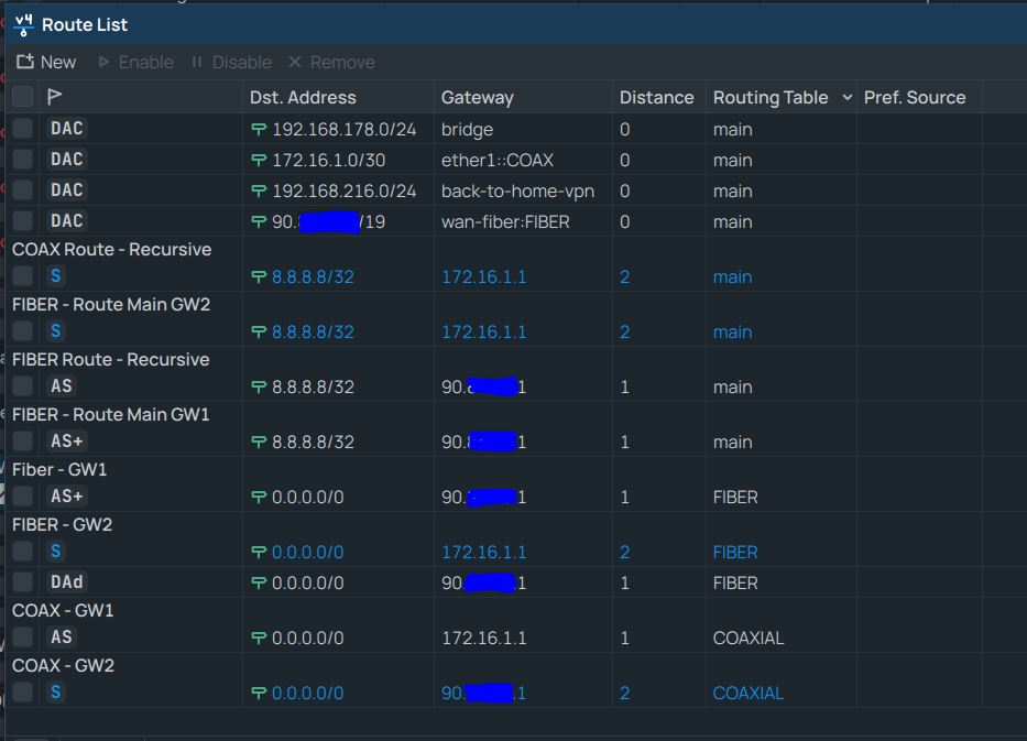

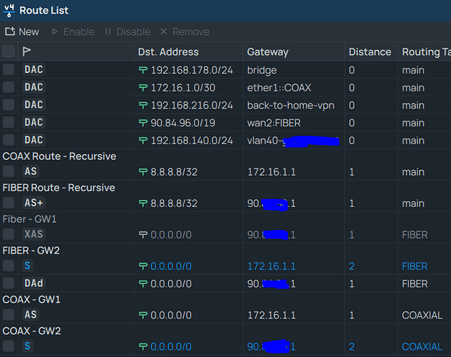

Kindly ask your support to untangle my brain on my setup. Trying here to configure my amazing RB5009 to use 2 WAN in a load balance and fail over. It would be great to have it working correctly as is now but i am grasping on the subject.
My setup is:
WAN1 - ether1: coaxial internet with fixed IP as i have the ISP router in front of the RB5009
WAN2 - ether6: fiber internet from ONT as DHCP client and vlan35
DNS - internal adguard home
Goal:

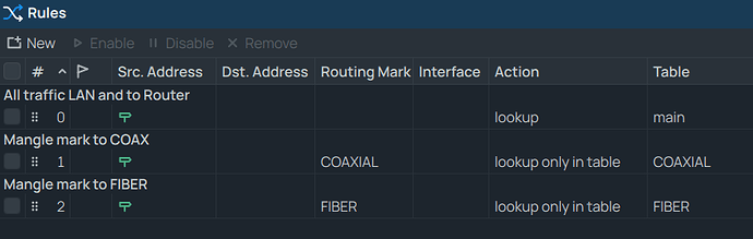

Policy based routing with load balance and fail over between the 2 WAN
IPTV box working fast :slight_smile: ; is not from the ISP

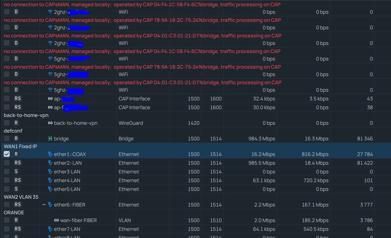

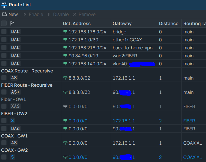

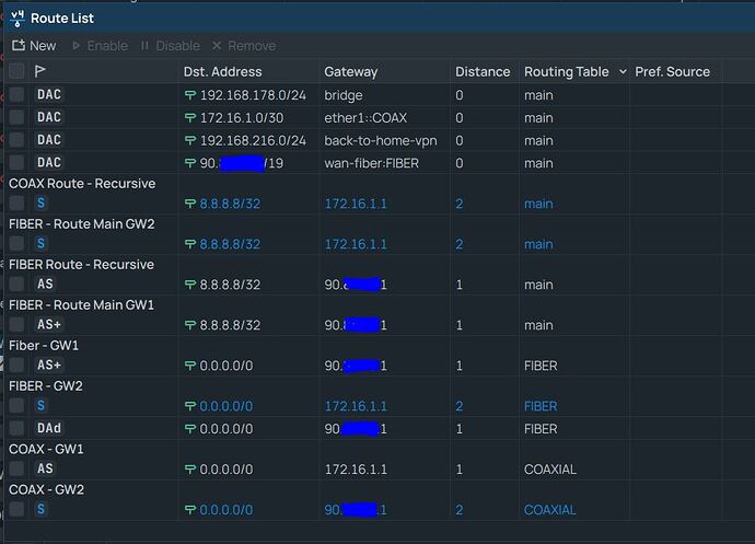

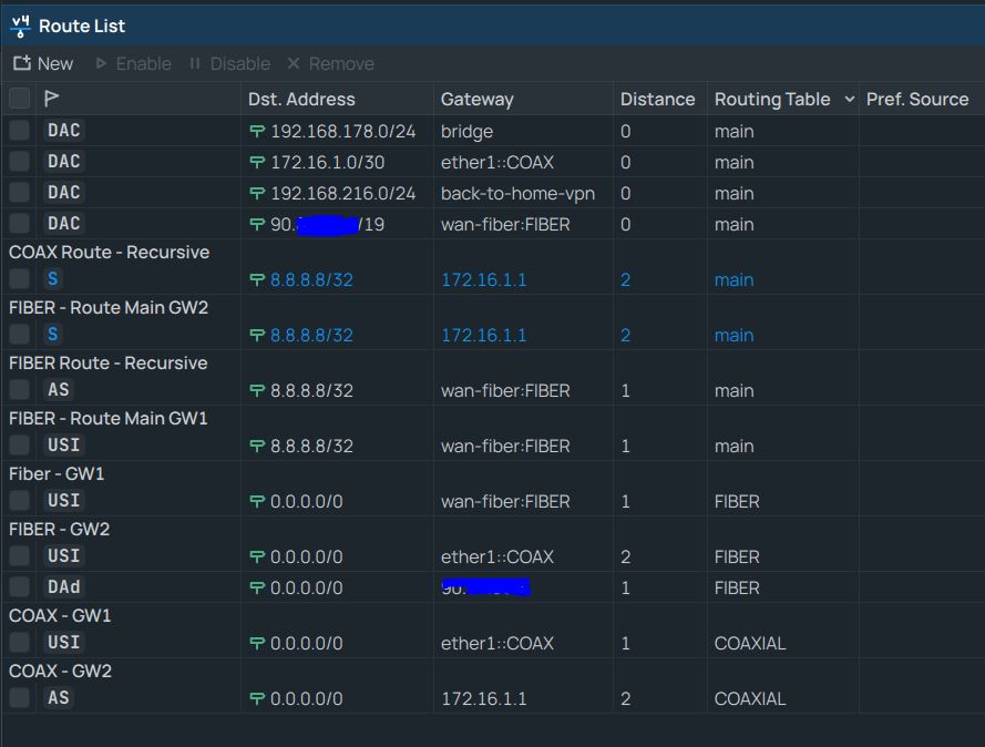

For the moment things mostly work but i think i have maybe some asymmetric routing as sometimes pages fail to load or there is delay. What i have trouble mostly is how to setup the routing with the fiber as is dhcp client and i am not sure i have it correct; for the WAN1 as is fixed ip and gw i think i get it.
Can you please take a look in my config, specially on the routing side, and help me achieve my goal?
Thanks in advance for your time and help!

add comment="COAX Route - Recursive" disabled=no distance=2 dst-address=8.8.8.8/32 gateway=172.16.1.1 routing-table=main scope=10 suppress-hw-offload=no target-scope=10
add check-gateway=ping comment="FIBER - Route Main GW2" disabled=no distance=2 dst-address=8.8.8.8/32 gateway=172.16.1.1 routing-table=main scope=11 suppress-hw-offload=\
    no target-scope=11
add comment="FIBER Route - Recursive" disabled=no distance=1 dst-address=8.8.8.8/32 gateway=wan-fiber:FIBER routing-table=main scope=10 suppress-hw-offload=no \
    target-scope=10
add check-gateway=ping comment="FIBER - Route Main GW1" disabled=no distance=1 dst-address=8.8.8.8/32 gateway=wan-fiber:FIBER routing-table=main scope=30 \
    suppress-hw-offload=no target-scope=11
add check-gateway=ping comment="Fiber - GW1" disabled=no distance=1 dst-address=0.0.0.0/0 gateway=wan-fiber:FIBER routing-table=FIBER scope=30 suppress-hw-offload=no \
    target-scope=11
add check-gateway=ping comment="FIBER - GW2" disabled=no distance=2 dst-address=0.0.0.0/0 gateway=ether1::COAX routing-table=FIBER scope=30 suppress-hw-offload=no \
    target-scope=11
add check-gateway=ping comment="COAX - GW1" disabled=no distance=1 dst-address=0.0.0.0/0 gateway=ether1::COAX routing-table=COAXIAL scope=30 suppress-hw-offload=no \
    target-scope=11
add check-gateway=ping comment="COAX - GW2" disabled=no distance=2 dst-address=0.0.0.0/0 gateway=172.16.1.1 routing-table=COAXIAL scope=30 suppress-hw-offload=no \
    target-scope=11

1st of all, you can’t have PBR with fail over, as PBR is static by definition. (You can however make a mixed config that employs both PBR and routing to achieve that)
2nd - load balancing can be done based on a whole lot of different factors, starting with just regular PCC, all the way to specific destinations, protocols, DSCP and whatever else you might think of. So you better clarify your request here.
In regards to DHCP/Static thing - DHCP client allows you to choose which routing table(s) (I see you already have one for each uplink) def gw should be installed, and with which distance.
Hey there Dartmaul
I can stick to PBR only and I was hoping my configuration would do a fail over if one of the GW are unreachable. But now, and for some reason i do not know, the routing table shows the FIBER gw as unreachable.
For load balancing I seek the simple way just using PCC. I also would like to implement a way to force a couple of source ips to use only the fiber WAN and make sure there is no asymmetric routing on that.
My routing setup aims to use both GW and auto swap if one is not available. But for now i am not sure it works - not tested yet - because I am still struggling to figure out why i have the situation as in the picture.

That’ll be a regular PCC. It relies on per-ISP routing tables, assuming that each has default gateway towards required ISP.
Also,
  1. why do you have all the ports bridged?
  2. why are interface naming inconsistent? what wan-fiber:FIBER suppose to mean?
UPD you would probably need dst-address-type=!local for the 1st jump rule of just add action=accept chain=prerouting comment=to_self dst-address-type=local as your 1st rule (as I have) to prevent yourself from accidentally locking yourself out of the router itself.

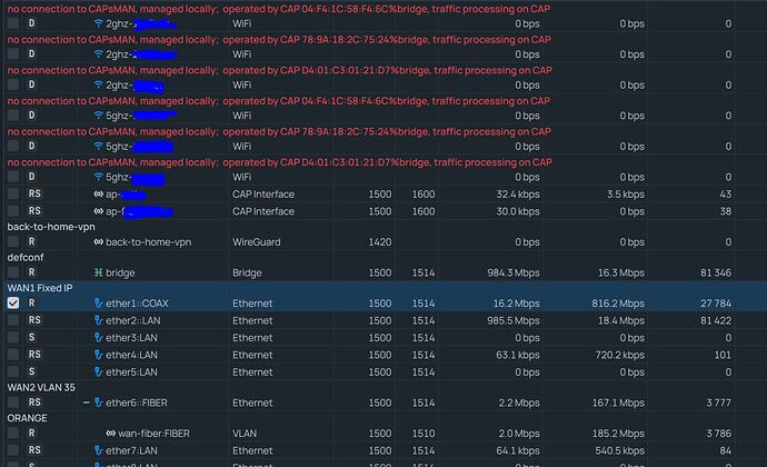

Also I think I am hitting some limit or wrong config as I am downloading LLM models and hitting 1Gbit speed, at the same time my CAPS all disconnect….

I think the bridge is saturated, did not catch the fiber WAN pushing as much as it was but was hitting +1200Mbit on the bridge a few seconds before.
If you haven’t yet removed WAN uplinks from your bridge, then you have interconnected your ISPs networks with your LAN, which may lead to a whole set of issues, such as concurrent DHCP servers, messed up ARP, lots of broadcast flood etc.

Also, your 8.8.8.8 routes won’t work as you expect: you don’t need 4 of them, just 2, and they have to be different GW same distance.

So, after reading a lot, made some changes as below and tested disable each interface in the router and testing with a youtube video and there was no interruption. Let me know what you think about the changes!
Post complete config as well as routes page for review
/export file=anynameyouwish ( minus router serial#, any public WANIP information, keys, dhcp lease lists )
What are the throughputs of both your ISPs?? ECMP load balancing is much simpler to to apply, than PCC If there are only a couple of IPs that need to go out a specific WAN, routing rules would be easier than mangling.
The ISPs throughput are:
COAX - 1G/150M
FIBER - 500M/250M (soon to be 1G download)
The current config:

add comment="COAX Route - Recursive" disabled=no distance=1 dst-address=\
    8.8.8.8/32 gateway=172.16.1.1 routing-table=main scope=10 \
add comment="FIBER Route - Recursive" disabled=no distance=1 dst-address=\
    8.8.8.8/32 gateway=90.REDDACTED.1 routing-table=main scope=10 \
add check-gateway=ping comment="FIBER - GW2" disabled=no distance=2 \
    dst-address=0.0.0.0/0 gateway=172.16.1.1 routing-table=FIBER scope=30 \
add check-gateway=ping comment="COAX - GW1" disabled=no distance=1 \
    dst-address=0.0.0.0/0 gateway=172.16.1.1 routing-table=COAXIAL scope=30 \
add check-gateway=ping comment="COAX - GW2" disabled=no distance=2 \
    dst-address=0.0.0.0/0 gateway=90.REDDACTED.1 routing-table=COAXIAL scope=30 \

/routing rule
add action=lookup comment="All traffic LAN and to Router" disabled=no table=\
    main
add action=lookup-only-in-table comment="Mangle mark to COAX" disabled=no \
    routing-mark=COAXIAL table=COAXIAL
add action=lookup-only-in-table comment="Mangle mark to FIBER" disabled=no \
    routing-mark=FIBER table=FIBER

Since you’re using upnp (which is a kind of dst-nat I mentioned before) you might need this one in your mangle
add action=mark-connection chain=postrouting comment=dst_natted connection-nat-state=dstnat new-connection-mark=dst_natted out-interface=bridge
I don't think it's needed. Those DSTNAT'ed connections (UPnP automatically inserts dstnat rules) will be handled normally by:
  • The two mark-connection rules on chain prerouting that have the interface=ether1::COAX and in-interface=wan2:FIBER conditions.
  • The two mark-routing rules on chain prerouting at the bottom of the table.
So even if UPnP only puts the forwarded ports on ether1::COAX, the rules above will still ensure that the responses go out using the correct interface.
Yes, seems that you’re right.
I just copied that rule from my own router which has similar multi-wan config, but since I have both of my uplinks with static IPs, I don’t mark incoming traffic, and just use src-address for routing rules instead.
Do you think I am in the good path now?
Or still a mess? :slight_smile:
