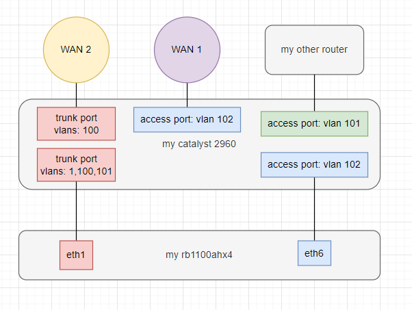

Main question is how to properly configure WAN 2 connection. This private ip ranges are given for example. Router is connected to two different internet providers.
WAN1 and WAN2 are working at same time. At WAN2 address 20.20.20.17/28 is used for my other routers.
Here is more explanation scheme.
And config:

Why is the switch needed before the router?
ether1, from wan1
ether2, from wan2
ether3, to other router
etc…
Because:
WAN1 is shared with other routers. There is another networks and routers in the same uplink which are connected to catalyst.
WAN2 physical uplink located at another building.
In case what is it that you wouild like to accomplish?
All use WAN1 as primary and WAN2 is used as secondary/backup only?
WAN1 user for some vlans WAn2 used for other vlans with the ability to use opposite WAN if yours fails.
