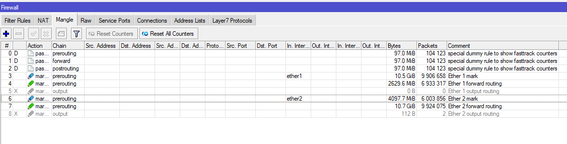

(6) SCRAP all your mangle rules as stated previously and replace with.
The first rule mark connections for all external traffic coming into the router on wan2 and the second rules ensure the traffic will be returned through the same WAN.
add chain=prerouting action=mark-connections connection-mark=no-mark
in-interface=ether2 new-connection-mark=incomingWAN2 passthrough=yes
add chain=prerouting action=mark-routing connection-mark=incomingWAN2
new-routing-mark= to_ether2 passthrough=no
What is important here too is that we ensure that the traffic does have the standard sourcenat rule to ensure the corrected traffic is given the correct WANIP, either using the default rule
OR the WANs spelled out separately as YOU HAVE BELOW which is good!!!
add action=masquerade chain=srcnat comment=VIVACOM out-interface=ether1
add action=masquerade chain=srcnat comment=TEA out-interface=ether2
There is no further mangling required. I would add that since some of this traffic concerns return traffic from the LAN, that we modify the forward chain firewall rule accordingly:
add action=fasttrack-connection chain=forward comment=“defconf: fasttrack”
connection-state=established,related hw-offload=yes connection-mark=no-mark

Ok, fixed the following
  • Interface lists: LAN (bridge), WAN (ether1, ether2), the rest are deleted
  • Changed the default drop rule to 3 rules as described by you
  • Changed the fasttrack-connection filter rule adding connection-mark=no-mark, couldn’t find the hw-offload=yes
  • Changed the hairpin Nat similar to the rules you provided
  • Fixed the inconstancies in the route, leaving the IP addresses instead of ether1/ether2, leaving the slower ISP route with lower distance
  • Disabled the Http service on port 8081
Tried your mangle rules, but creating them for ether1 and ether2 - the result is that I loose remote connectivity to the router every few seconds.
With the above changes: If slow ISP has lower routing distance I can access a server using both WAN IPS, If the faster one has lower routing distance I still can access the server only using the faster ISP IP address

Edit: Just tried the Mangle rules only on the Slow ISP as described by you or the other participant.
If the marking rule on the prerouting has passthrough enabled, and connection mark no-mark, the other forward rule with the mark route action disabled, and the output rule added, then port-forwarding for this ISP stops working.
Tired it with my rules as well - passthrough enabled, and connection mark no-mark breaks the port-forwarding for the ISP
I’m adding a screen shot the Mangle rules page, and as you can see the traffic is marked

(2) Mangle rules should be.
/ip firewall mangle
add action=mark-connection chain=prerouting connection-mark=no-mark
in-interface=ether1 new-connection-mark=ether1_mark passthrough=yes
add action=mark-routing chain=output comment=“Ether 1 forward routing”
connection-mark=ether1_mark new-routing-mark=to_ether1 passthrough=no
in-interface=ether2 new-connection-mark=ether2_mark passthrough=yes
add action=mark-routing chain=output comment=“Ether 2 forward routing”
connection-mark=ether2_mark new-routing-mark=to_ether2 passthrough=no
These four rules ensure any traffic coming in on either WAN go out the SAME WAN.
