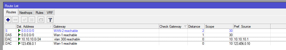

I have two Wan connections that were both connected to my router via dhcp and I used a simple wan failover script using route distances in case one went down, the other kicked in. This has been working great until our main connection changed to using pppoe instead.
Now when if our main connection goes down, the second wan doesnt kick in. I’ve also noticed that a dynamically connected route has been created for our public ip address (123.456.0.10 ) and what I assume is our ISP’s gateway (123.456.0.1).
I’ve attached a pic to show.
Has anyone any suggestions how I can setup a failover now?

Should work??
post config

Well for starters
I see an Ip address for one WAN not two??
I see a srcnat rule for one WAN not two??
In terms of IP routes, the basic schematic looks like
/ip route> add dst-address=0.0.0.0/0 gateway(ip address)=10.0.0.1 (or gateway=ether1)
So it appears your missing something??

I did a quick test today and I noticed that I have to disable both the WAN1 port and the pppoe link for WAN2 to kick in.
Your PPPOE link should be the one in the route rules (not the WAN1 port).
it is in the route rules, but when testing I had to disable both the wan1 and pppoe interfaces to get wan 2 to kick in.
So I’ve my router up and running again ater the reset, But the failover still isnt working. I’ve attached the settings below and a grab of the routes from win box.
I do have internet access from WAN2 via vlan300, but if I disable the WAN1 and/or WAN1-pppoe nothing else routes through WAN2, except vlan300. I was able to setup a failover easily before WAN1 became a PPPoe connection. I’ve tried scripts and marking but nothing works.
