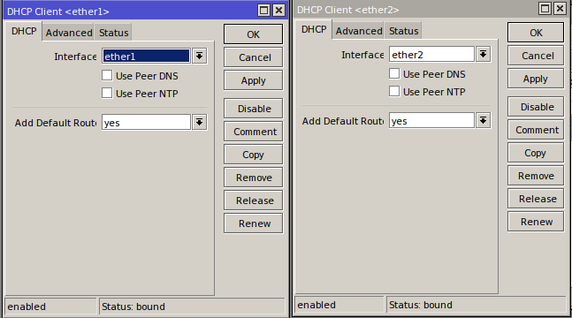

InoX your solution worked awesomely well for me. This is on my hapAC (MikroTik RouterOS 6.40.3 (c) 1999-2017) dual wan failover with DHCP on wan ports.
I have ether1 (WAN1) connected to a TWC DOCSIS3.0 modem, and ether2 (WAN2) connected to a google fiber.
::For WAN1::
IP > DHCP Client > DHCP tab > interface: ether1; add default route : yes

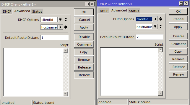

IP > DHCP Client > Advanced tab > Default Route Distance: 1

IP > DHCP Client > DHCP tab > interface: ether2; add default route : yes
IP > DHCP Client > Advanced tab > Default Route Distance: 2
I had static routes set with scope and distance setting per some previous posts, I have now deleted them now. These are not needed if one uses InOX’s solution.

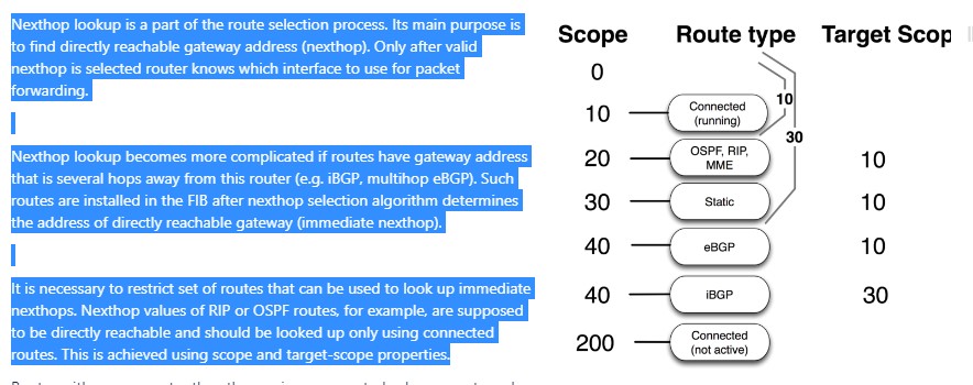

The mechanism is as such: by playing with “scope” one can assign/use/check a remote (not directly reachable) gateway. (AFAIK this comes from iBGP routing. Not the simple routing we know)
The clue is to set scope on 10 while checking for reachability for that remote gateway

add comment=“check 4G recursive for default route ( scope = 10! )” distance=1 dst-address=8.8.4.4/32 gateway=192.168.95.1 scope=10
add comment=“check SkyDSL recursive for default route ( scope = 10!)” distance=1 dst-address=8.8.8.8/32 gateway=192.168.90.1 scope=10****Route set#4:
this is the clue. This set of routes that make the gateways for route set #1 reachable, if they are reachable via multiple in between routers. (recursive)
The basic requirement for those routes to help out route set #1 is that the scope is 10 . Standard static routes are added with scope 30 !
If the gateway is reachable the corresponding route from set #1 is UP. If the gateway is NOT reachable, the corresponding route in route set #1 is DOWN.
This route set #4 is not used for data traffic (except for something directly addressed at the named gateways, like a DNS lookup)
See the wiki confusing doc: ( THE clue: we create a static route with scope 10 (value normally reserved for directly connected paths only).
And we know that static routes (with target scope 10) , do use routes with scope 10 as helpers. iBGP does something similar by setting “target scope” to 30.)
https://help.mikrotik.com/docs/display/ROS/How+Packets+Are+Routed
Distance I understand,
Scope is still a mystery…
