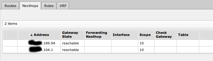

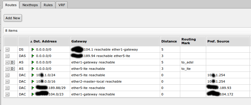

I’m trying to set up dual WAN connections without luck. The firewall filter and magle rules mark the connections and create routing marks. Packets marked (for example to 1.2.3.4) seem to get mark, but cannot figure out how to get the packets to use different WAN interface. With setup below, traffic in and out work but only using ether5-lte interface.
The dhcp-client inserts the routes to main table for both interfaces. How do I get it to create entries to separate routing tables? In the nexthops the table remains empty and outgoing traffic marked with to_adsl routing mark results “no route to host” (icmp message destination unreachable returned).

Use routing filters to set routing table for dhcp routes, see e.g. here.
Thank you Sob about help. The routing filter was the correct approach and setup is ALMOST working.
All traffic normally goes to lte-connection and MOST packets marked with to_adsl connection-mark to adsl-connection. With most I mean that for example ping to 4.2.2.2 (marked with magle-rules below) works, except with huge packet loss, something like 40%. Also incomining dstnat:tted connections work, but with packet loss (ssh-connection looks like working, but hangs occasionally).
Any idea where to look for to problem?
