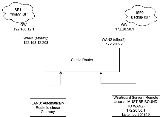

Hi everyone, I have a router setup for Dual WAN connectivity for automatic fail-over. It is working great.
RouterOS 7.21 RB5009
However, I need to run a WireGuard VPN server on ONLY WAN2, where I will have a client attach, and I am having trouble with getting this to work.
Basic diagram of my setup:
I’ve setup recursive routing to check gateways for both WAN’s, which is working, and allowing the backup WAN port to pass traffic.

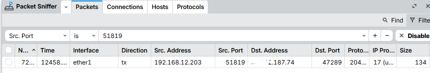

So regular traffic is working fine, but now I try to connect to this Routers WireGuard tunnel on its WAN2 address from my remote device. Handshake fails.
As you can see below, Packets are coming in on ether2, however they are leaving via the default route, on ether1
So my first attempt was to use a Mangle rule to mark all packets with source port 51819 (the local WireGuard interface) and send these to a new routing table, which forces WAN2

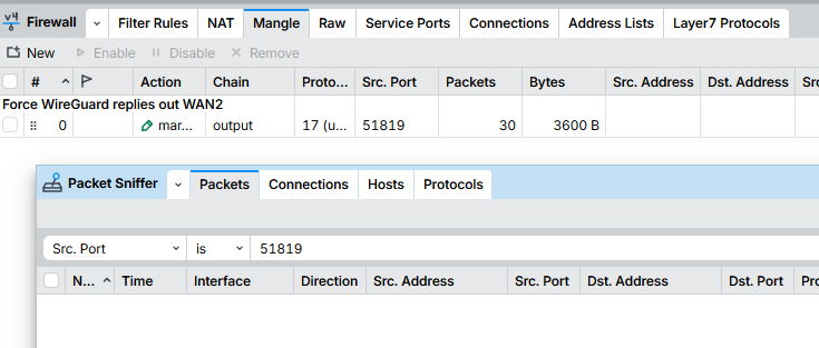

I then set the following mangle rules to mark the packets with source port 51819 (wireguard port) and hopefully allow them to route through WAN2:
/ip firewall mangle
add chain=output protocol=udp src-port=51819 \
    action=mark-routing new-routing-mark=to_WAN2 passthrough=no \
    comment="Force WireGuard replies out WAN2"
I see this rule is being hit, as the packet counter is incrementing, however, the packet sniffer now shows no packets, so with this rule it now appears to not be hitting any interfaces:
So it appears the mangle rule is unfortunately not working for this setup. So I tried another way, maybe a routing rule will work.
I clear out the Mangle rule, and enter this routing rule:
/routing rule add action=lookup-only-in-table disabled=no interface=StudioEngineer table=to_WAN2
I now check the packet sniffer again, and this time its like it completely ignores my routing rule, and still proceeds to send traffic out ether1
I’m pretty lost here at what to try next. Any suggestions would be greatly appreciated. Below is my entire router configuration (All of the VLAN etc configuration can be ignored):
