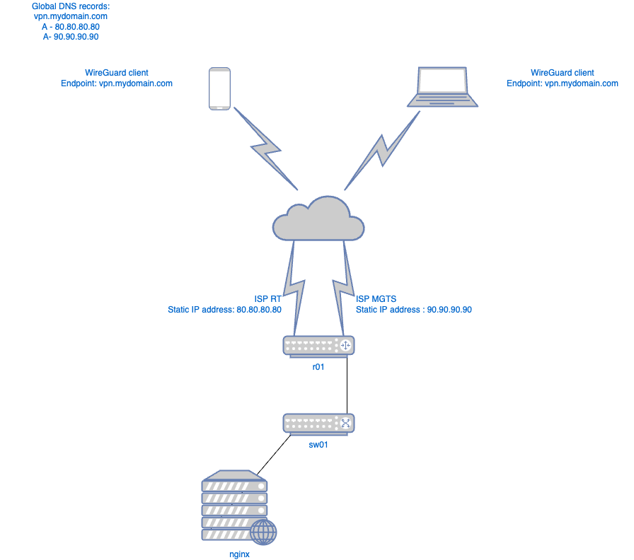

A couple of days ago, I get a second ISP connection from another provider and after configuring the router to use both connections via PCC, I couldn’t get working WireGuard connections for my mobile devices. I’ve added a second IP address as A record to the external DNS service for the domain name of my VPN endpoint. Internet on local devices works fine, PCC working correctly, and clients directly connected to router haven’t any issues with Internet connection.
The router works as WireGuard server and external clients connecting to it via mobile internet. When I disable interface from one of ISPs mobile clients can connect via one ISP with external IP address.
Current setup with obfuscated sensible data:
ISP RT: Static External IP - 80.80.80.80
ISP MGTS: Static External IP - 90.90.90.90
External DNS name of WireGuard VPN server endpoint: vpn.mydomain.com
Attaching config without sensible data to this topic. Maybe somebody could give me a hint what I’m doing wrong in this dual WAN configuration?

Being not familiar with records, do you mean that you have two entries for your dyndns url?
I mean that I’ve got personal domain and using control panel where I can place A records for my domain name.
If so is their a primary record which points to lets say ISP1-WAN1 and a secondary record that points to ISP2-WAN2?
In other words is it fair to say that all users will then go via WAN1 for wireguard if both are available??
A records are having same weight and DNS server of provider will sent A record with IPs randomly. In one moment it can be IP address that belongs to ISP1, in another moment it can be ISP2.
(Assuming its two separate providers of course otherwise dual wan would not provide any redundancy)
Yes, in my case it is 2 separated providers.
