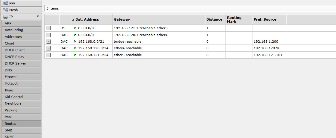

I see that all the traffic goes through eth4. eth3 has only little traffic, communications between the 2 routers, i think.
What makes the router choose eth4 instead of eth3?
Can i see a screenshot of your routing Table ?
This one?
Ok, i thought i would see an automatic ECMP applied, but no…
If there are no administrative distance set traffic goes from port 4 because has lowest IP Subnet 192.168.120.0/24 vs 192.168.121.0/24
If you want to set which of them should work you can remove add default route to NO in IP>DHCP Client and add them manually with different distance! Lowest distance win i this case! And to make this automatic failover set check gateway ping when add default gateway!
You don’t really need to set “add default route” to no: DHCP-client (as well as PPPoE-client, L2TP-client, etc.) have “Default route distance” setting, so automatic route creation can still be used with needed distance.
