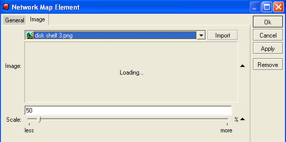

There is an intermittent problem in Dude 3.4 (but I’ve noticed it in previous versions back to 3.0).
Sometimes an image will not display on a map. All places where the same image would appear just have nothing.
Example: image is loaded
But exit the Dude client and start it again (after 5 times this happens):
It is usually the first time that I start the Dude for the day that some images are missing. But can occur at any time.
When I look at the Appearance of the network element, I see Loading…
The images that have problems seem to change after I make changes to the maps and load new images and delete old ones.
But if an image is bad, then it disappears for all the maps at once. It usually comes back after restarting the Dude client.
+1

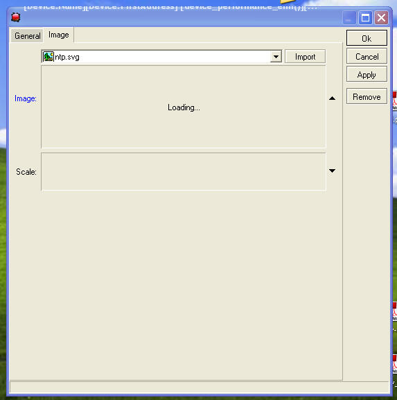

After altering the maps and devices to use the new images, I noticed another problem:
All of the images now work except for ntp.svg (the one that comes with Dude).
Also note that the title bar is not correct.
When I right-click on a device and choose Settings the settings box appears with a title bar that says “mydevice - Device”.
When I right-click on a device and choose Appearance the settings box appears with a title bar that has a shifted up copy of the Device label format string in it. I have verified this against submaps and links too - they contain the label format string for submaps and labels.

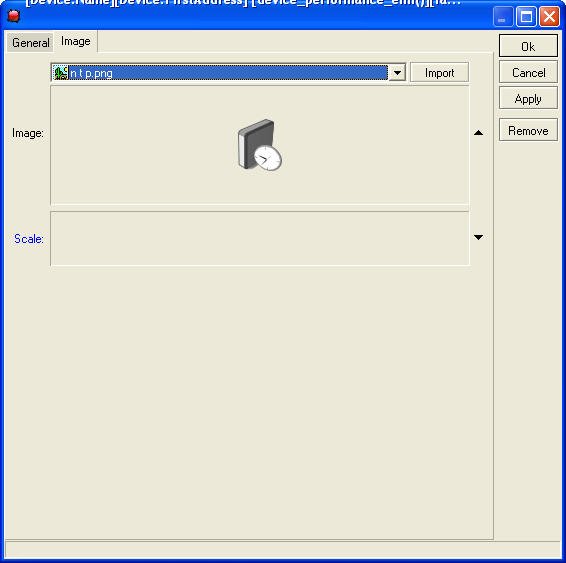

To fix the ntp.svg problem, I was bad and converted it to png as: “n t p.png”
I started a Dude client, uploaded “n t p.png”, and the went to change the appearance of my Time Server.
But I found that “ntp.svg” displayed perfectly, I selected “n t p.png” and it just said “Loading…”
I shut down Dude, and though to myself “what is happening”.
Then I started Dude client again, and looked at the Time Server.
It’s image was gone.
I selected “ntp.svg” and it said “Loading…” :cry: It worked 5 seconds ago…
Then I changed the image to “n t p.png” and it displayed perfectly. But 5 seconds ago it was broken…
