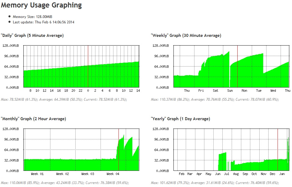

The problem is, that since I istalled Dude, it is continuously eating the memory. See the graph:
Description:
Dude installed first time on Friday. See what it did.
ROS updated to v. 6.9 on Sunday. Several reboots, Dude uninstall, install again. Since then it is continuously eating the memory.
No changes to dude shchemes, nor other changes.
So now what? Is it the behaviour that it should be? What shall I do after two days when memory will be out?
How can I expect it will run on RBs with 64MB of memory (Omnitiks)?

Anyway, before reset, I just restarted the router. And it is starting at 40MB of RAM used. Wondering how it will be growing… The strange thing is that two days ago it started at 64MB used…

I am attaching the graph after last restar on Tuesday. It started growing from 40MB (much lower start then after previous restart).
I have read somewhere (do not have link now) that someone was told by someone from Mikrotik that Dude is keeping data in memory until the data are written to disk. And writing should be done periodically.
I do not know how to manage the writing period, but it seems that even the data are written to disk (not lost by reboot), the memory is not freed. Seems this could be the reason. Or the reboot is started by data writing and performed after the data are written?

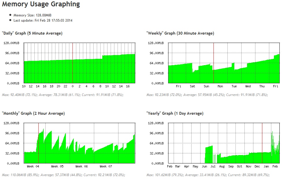

I have changed the usb flash disk on Saturday afternoon. I had many problems with accepting the flashdisks but finally I managed to reliable run one of them. So I was able to throw away old (maybe 10 years or so) 128MB flash disk which was till now used as storage for logging and Dude data. I put there 7GB much newer usb flash disk.
Meanwhile I realised that if I have whatever that writes to usb flash, it can prevent usb1 disk mounting, because the mounting can take some time after mikrotik starts. If meanwhile some script or log writes to (e.g. "usb1/log.txt) it cannot address the so far not mounted disk. Therefore new directory with name “usb1” is created on the internal flash memory. Unfortunatelly, subsequent mounting of USB flash disk will not happen. Therefore the solution: Postpone writing by scripts at least 2 minutes from start to get some time for usb1 mounting.
Since then I have no running problems with Dude, data is not lost, Dude survived all restarts so far.
But this is not solving the continuous memory consumption, as you can see on the actual graph:
What does it say?
  1. it seems that the graph slope is much lower, it means, the memory consumption is slower. But it is still present!
  2. the big jumps up are due to xml exports for backups from the Dude client.
So, it seems that Dude works (functionally) really better than before, even the memory problem is not solved.
