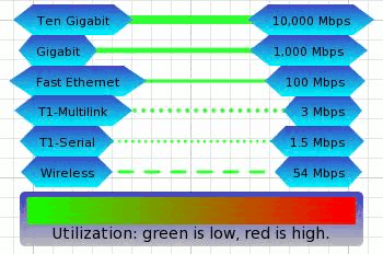

I just tried the + sign look at the included image also when an upload is successful it just puts the file in the root folder instead of giving a choice of where to upload it to. Drag and drop is easier…

Anyhow here is the test image and the screen shot of the failure to upload. Note I tried to upload this file 3 times just renaming the file each time…
change the jpg file to png.
just change the extension , it works for me great..
For me it was just changing the case NewNetwork.JPG to newnetwork.jpg then drag and drop. I use Dude 4.0beta3.
