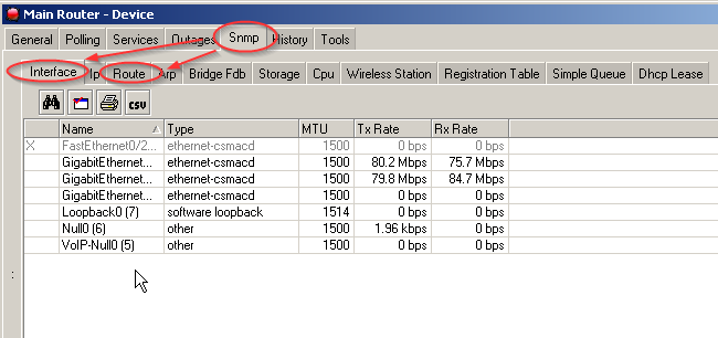

There are some conditions which could lead to high cpu on cisco. I know (have realy experienced) 2 conditions
  1. You have a lot of interfaces on your device. It could be, for a sample, on router holding a lot of pptp sessions.
  2. You have a lot of routes on your device. It could be, for a sample on a router holding eBGP sessions.
    In such a cases high cpu is detected when The Dude is trying to construct tables for device snmp tabs.
    The solution is to disable corresponding snmp subtrees on cisco device.

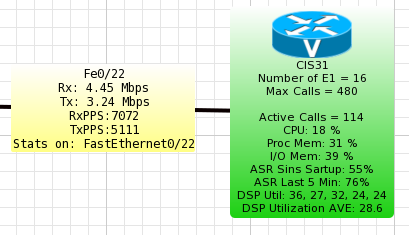

I do monitor CPU, Temperature, Traffic and memory on all my cisco routers. Also number of Active Calls, DSP resources, ASR (Answer Seizure Ratio), number of E1 in UP state on VoIP Access Servers.
Not any high cpu caused by my probes.
Interesting.. wouldn’t have imagined monitoring call status using the Dude (Cisco must hate you for not using their fine software!) :wink:
how are you polling this data in your interface/device labels? Just created a function “oid(1.2.3.4.5.6.7…)” or did you create a function with conditions for each? How often do you refresh the labels?
I am monitoring CPU and free RAM to be able to see things like memory leaks and other issues that only become apparent when monitored for several weeks but I also need to monitor the interface status and interface description (needed for automatic alarms/notifications to our NOC for customer connections)
BTW: I like the pps in your labels.. somehow more useful than bits/second for big trunks!

My label for TxPPS/RxPPS code is:
Fe0/22
Rx: [Interface.InBitRate]
Tx: [Interface.OutBitRate]
RxPPS:[Interface.InUnicastPacketsRate]
TxPPS:[Interface.OutUnicastPacketsRate]
Stats on: [oid(concatenate("1.3.6.1.2.1.2.2.1.2.",link_index()))]

I found out when you open device and go to SNMP tab it creates like 20000 packets extra on the ACL - is this a feature? Half of the packets is UDP, the other half TCP

The Dude is polling by default.
Yes you are wrong in cisco config.
You had only included some subtrees, but you also have to exclude all the others. So all the snmp tree is included in your config.
The best practice is to include all by default, and exclude all you do not want to be accessible.
In your case the config should be.
snmp-server view TheDude iso included
snmp-server view TheDude  iproute excluded
snmp-server community ********* view TheDude ro 6
First - include the root (and all the subtrees).
Second - exclude routing information.
That is all.
The Dude will try to get your routing information, and cisco will return nothing to snmp request. So The Dude will not send more snmp packets.
