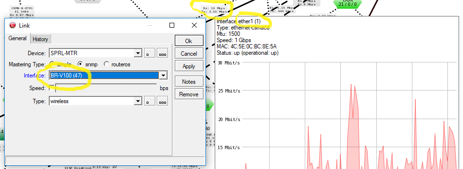

Link labels sometimes shows RX/TX ??
If i change Link - Mastering Type to RouterOS instead of SNMP - It shows Ether1. It doesn’t work with non-mikrotik devices

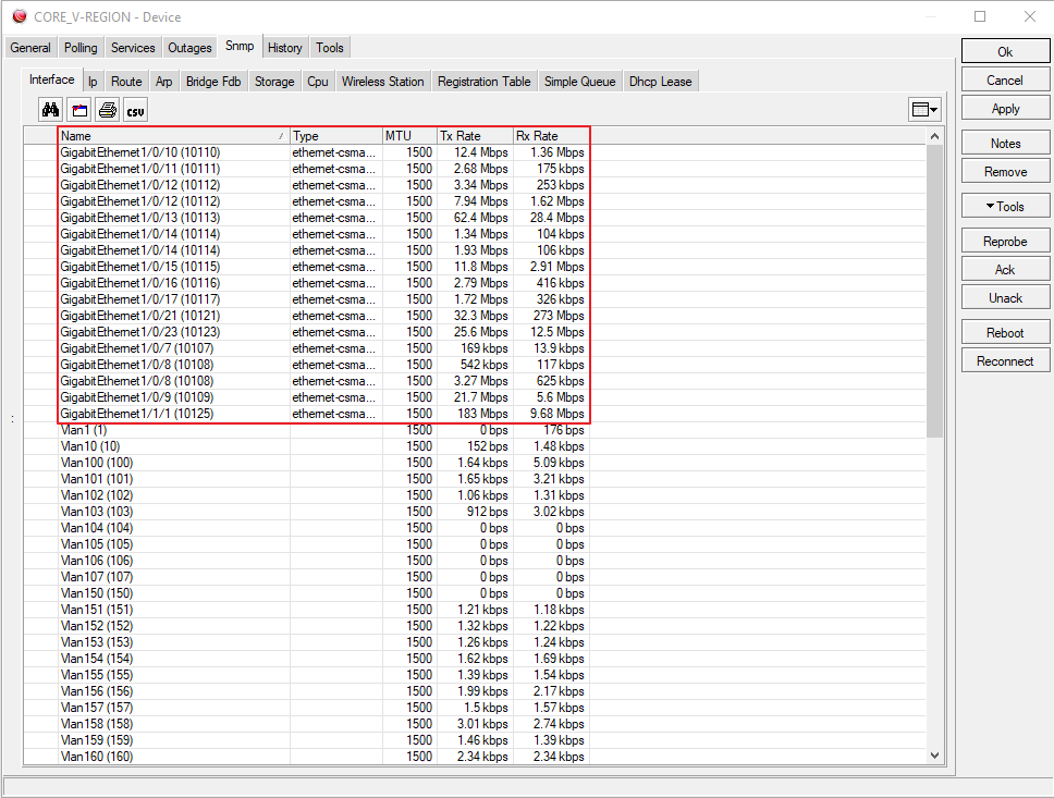

I have the same problem, I lose interfaces and it does not allow me to connect devices, this happens with version 6.42.7. Someone knows how to solve this problem.
In the attached image, example, I try to connect to the Gig 1/0/20 interface and it is not shown, several interfaces are lost, this happens to me at a global level.

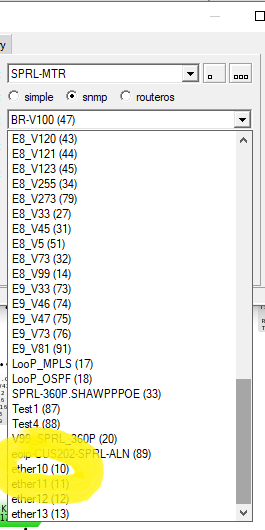

Also have another problem with wlan ifaces while monitoring devices running OpenWrt 18.06 (OIDs discovered by SMNPwalk)
While working few days, this interfaces simultaneosly change their indexes and accumulate own non-working copies (“zombies”) in the dropdown list of intefaces
this copies have different indexes like
wlan0(19) - zombie (previous working)
wlan0(20) - zombie (previous working)
wlan0(22) - working
wlan0(30) - zombie (previous working)
wlan0(33) - zombie (previous working)
And that’s why correct monitoring going to be impossible ..
