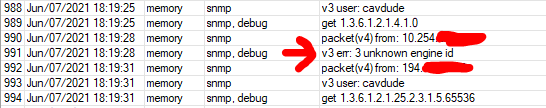

Setting The Dude 6.48.3 and same devices are not properly responding do SNMP
The main problem is on the picture. Same source device, same target.
Same Dude server but once it is connected via public IP 194.x.y.z and the second is vi VPN.
Removing, adding … reprobing … same problem
Server on 1100AHx4Dude, Probed device is RB 4011iGS+ but other non 4011 device behave same way.

Of course I did. The log is from the same device monitored from one Dude server
Lines 1,2,6,7,8 are log of communiction with Dude via public interface.
Lines 3,4,5 are log of “talk” made by “local” interface = VPN connection

No matter what, the problem still exists: what is the cause of “unknown engine id”?
