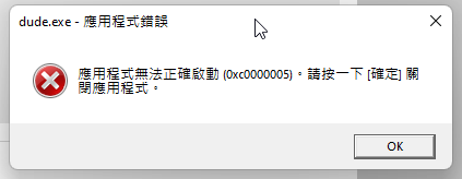

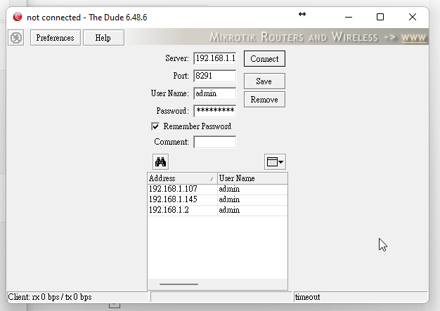

I am not able to start 7.1 and 7.1rc in windows 11. v6.x works.
6.48.6
7.1 and 7.1rc (sorry the dialog is in chinese)

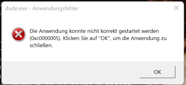

The message Application unable to start correctly 0xc0000005 can appear when trying to launch an application

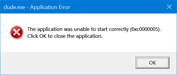

This also happens on my Windows 10 Laptop running 21H1 Build 19043.1348
Launching The Dude with administrative privilages does not result in an error message but the Program will not launch regardless.
Same issue here on a Win 10 21H2 box.

Running normally: 0xc0000005 error at start-up, and that’s it. Process not present.
Running as admin: nothing (no message, no start), process not present.

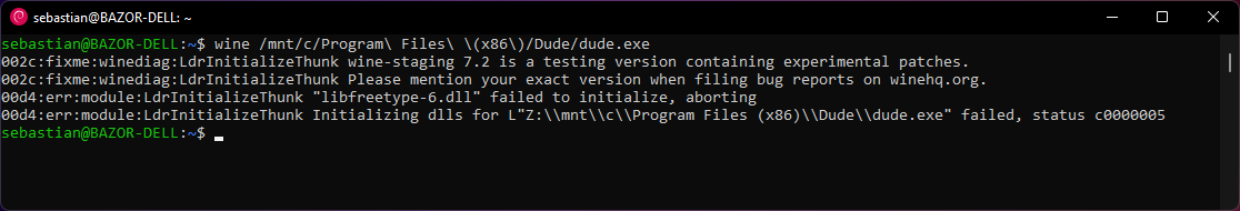

I’ve tried the WSL route to no avail. So don’t bother. It will reliably fail with the same cryptic error code.
We’ve gotta think harder than that. First of all, how big is the desire to run this software on Windows 11? Quite a lot, I believe. Many would consider Wine on WSL crazy, if not outright blasphemous. That includes the official Wine documentation. Of course it does work with e.g. notepad, but not in this particular case. Let’s try something different.

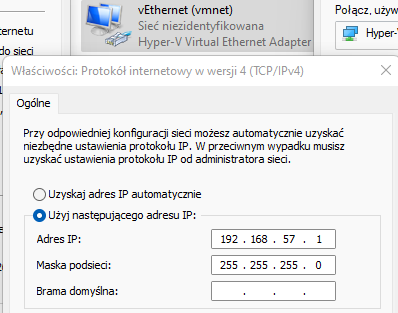

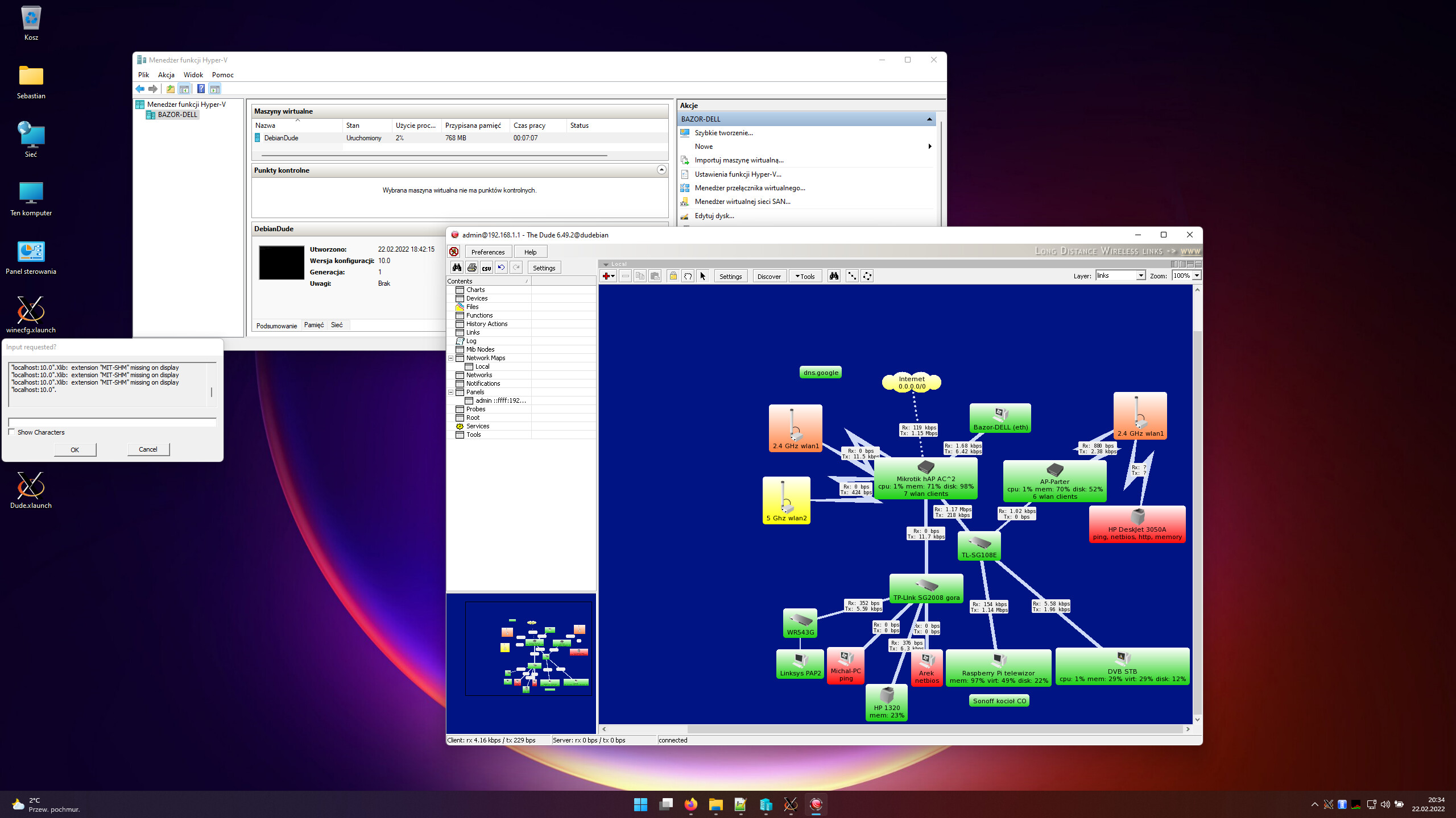

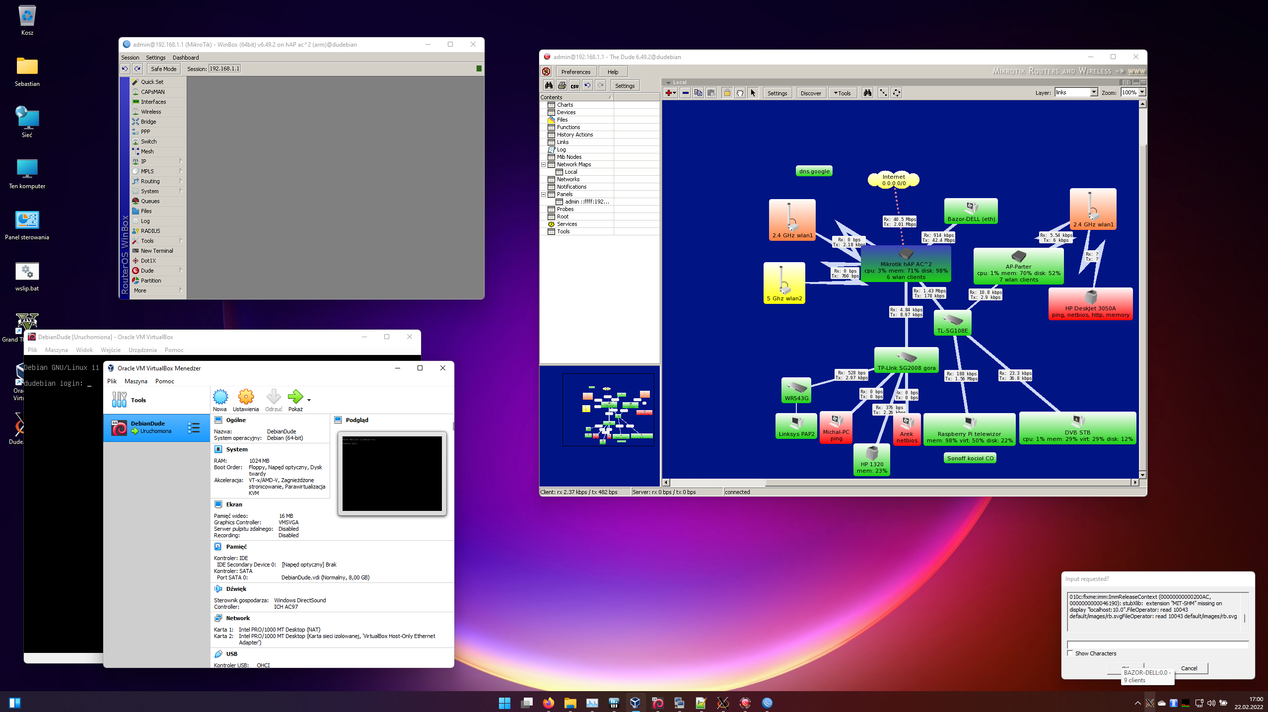

I’ve spun up a VM in VirtualBox and installed Debian. Later I’ve migrated it to Hyper-V for better performance and integration with Windows. Hyper-V comes only with Pro versions of Windows, so use whichever you have at hand. 8 GB drive, 1GB RAM and 2 cores is plenty. You will need two network interfaces: one comes default, with NAT to access internet and your Dude instance; another to connect on X server on host OS (read on!). You need to create another virtual switch configured as “internal network”. A virtual Ethernet device will be created and I’ve set some private address to it (192.168.57.1/24 in my case).
It doesn’t differ a lot in VirtualBox.
After booting the VM, install Debian with default settings on a single partition to keep things simple. Uncheck desktop, GNOME etc. in tasksel, leave checked only “standard system utilities” and (important) ssh. Then install WineHQ according to instructions. I chose winehq-staging because I like risk but not danger. Setup network interfaces (/etc/network/interfaces):
allow-hotplug eth0
iface eth0 inet dhcp
auto eth1
iface eth1 inet static
	address 192.168.57.2/24
The interfaces might be named like enp0s3 in VirtualBox so pay attention. The static address of eth1 is of course supposed to connect with host Windows vEthernet, so please set addresses accordingly. Use another subnet if this one overlaps with your network. Place host’s address in DISPLAY env variable of your user (not root!):
echo "export DISPLAY=192.168.57.1:0 >> ~/.bashrc
. You may restart networking in systemctl to enable your IP address, and log out then log in to read .bashrc… or just reboot, it will be super fast anyway. The system is ready to start GUI apps, it just needs an X server. VcXsrv is good enough on basic settings, just check “Disable access control” to allow network connection. Note: it allows anyone in your network to pop windows on your desktop, so you might want to seal this hole using windows firewall or host-based access. Refer to VcXsrv documentation for that. When you’ve got your X server up and running, you can now
wget https://download.mikrotik.com/routeros/7.1.3/dude-install-7.1.3.exe
wine dude-install-7.1.3.exe
wine .wine/drive_c/Program\ Files\ \(x86\)/Dude/dude.exe
and from now on it goes almost as easy as it would on Windows. If you want to do something about the ugly default Wine theme, there’s a Windows 10 inspired one: https://www.reddit.com/r/linux_gaming/comments/n8hf6v/make_wine_look_like_windows_10/. And more importantly, a launch file so you don’t need to type it every time. Create a text file Dude.xlaunch
<?xml version="1.0" encoding="UTF-8"?>
<XLaunch WindowMode="MultiWindow" ClientMode="StartProgram" LocalClient="False" Display="-1" RemoteProgram="wine /home/dude/.wine/drive_c/Program\ Files\ \(x86\)/Dude/dude.exe 2> /dev/null > /dev/null" RemotePassword="12345" PrivateKey="" RemoteHost="192.168.57.2" RemoteUser="dude" XDMCPHost="" XDMCPBroadcast="False" XDMCPIndirect="False" Clipboard="True" ClipboardPrimary="True" ExtraParams="" Wgl="True" DisableAC="True" XDMCPTerminate="False"/>
Adjust RemotePassword, RemoteHost, RemoteUser accordingly. Remove
to have a super-annoying window with log pop up everytime you touch anything in Dude window. Or better don’t. Place this file on your desktop and double-click it anytime you want to use The Dude. You will need a running VM in the background for this to work, but from what I’ve found i doesn’t burden my computer a lot. One could think of a PowerShell script for starting and shutting down the VM, but I’m way too lazy for that. And this hack will hopefully lose its usefulness, as I hope that The Dude gets fixed soon.
note: I’ve found out that plink.exe that comes with VcXsrv has a bug that prevents using launch files, producing a weird error about unknown parameter ssh. I’ve procured plink.exe that’s not broken from PuTTY’s website and replaced it in
C:\Program Files\VcXsrv

I’ve tried this on the nearest 3 Windows 10 computers I could find and got the same error msg on all of them.
Because I only wanted to test out the Dude I played around with and downgraded my ‎RB750Gr3 to v6.48 (all good practice) with the same version Dude client and server. As I’m sure you’ll all guessed it worked fine.
Of course it all broke again when I upgraded and tried the 7.1.3 Stable client.
I would really like to know if ANYONE has the Dude client version 7.1 working on Windows 10 or 11?
I’ve just noticed version 7.2rc4 Testing and gave that a try. The only difference is I have to dig around in Windows Event Viewer to find the same error.
