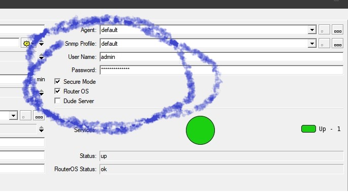

On top of that, I have also many login failures from “admin” with the same IP address (the Dude) as the successful logins.
But this administrator “admin” doesn’t exist in my network. I tried all possible Dude settings, pollings, services etc. that could try to access router with this “admin” but I can’t find it.

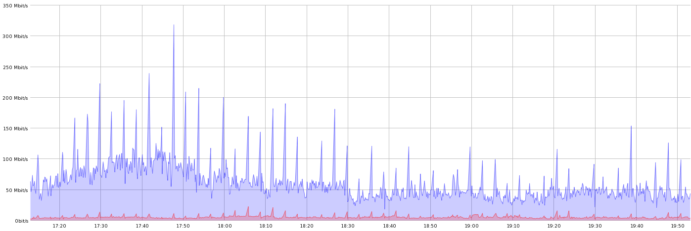

Yes, I already did that.. All the graphs are with saw-like spikes :slight_smile: Completely useless… This is graph for 100M link:

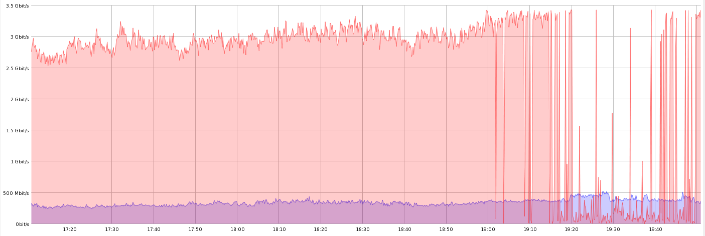

I don’t feel anything in 6.47.x. I thought it will solve this issue:
But it didn’t.. Everything >3Gbps in Dude graphs looks like this :slight_smile:

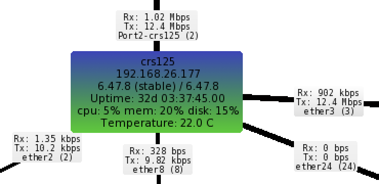

I’m also on that version. Indeed no reconnects every half a minute, everything else works fine too. I have currently set label refresh time to 0:08, and that graph successfuly displays everything up to 5Gbps. Didn’t try custom probes yet. I’ve heard there are success stories with 64bit counters.
I am on dude 6.47.8 without any problems …
(Max connection speed is 1GB/s here)

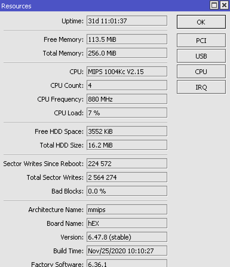

Than try run dude on multi-core CCR. No old single core MIPS.
dude is running on a dedicated RB750Gr3 which has a 4-core cpu …
Good news works with MMIPS 4 Threads. NO 4 core https://mikrotik.com/product/RB750Gr3.
Are u 100% sure monitoring any mikrotik device ? No snmp just ROS protocol ?
my RB750Gr3 says cpu-count 4 …

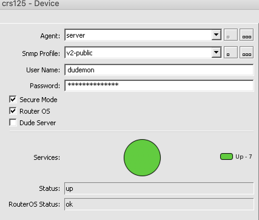

I am monitoring all my MT devices with both ROS monitoring and SNMP …
