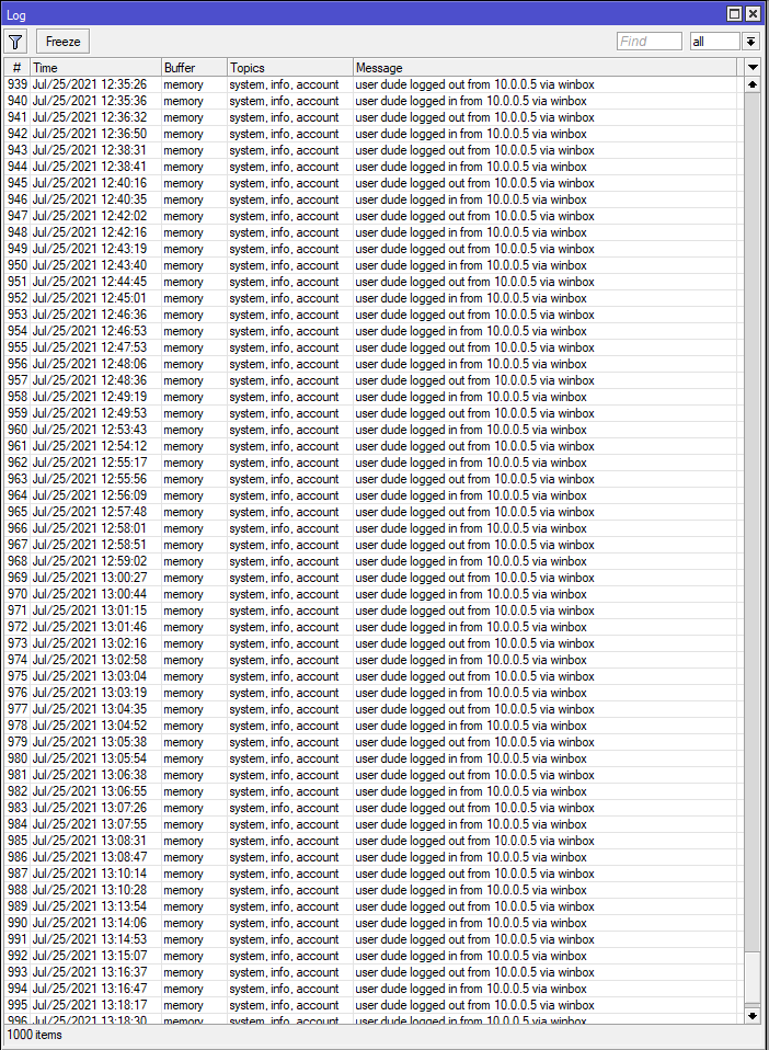

Here, look at this beauty. No wonder the dude is going crazy. And now imagine if the dude has a 3000 routerboard.
Imagine that for many years the network with 3000+ MikroTik’s was monitored by an update through a dude, and used ros_info and ros_command for this purpose. And here is an update that breaks everything. I understand you do everything as easy as possible for you. But we have been buying your products for many years and have the right to be treated humanely. For many years, please make the dude a commercial product. we are ready to pay, but make a quality product !!!

Are these enough?
It’s perfectly normal than the connection is open just for execute the command and then closed,
It’s perfectly normal than the connection is logged on RouterBOARD log,
What you expect from this?

That is the Log of ONE RouterBOARD, not the Log of The Dude, or at most it is the RouterBOARD where The Dude is that self-interrogates…
However it goes, each RouterBOARD has its own Log, not all 3000 are put together.

And again, you understand this?:
Probably that is a new choice, instead to keep connection alive for thousand of devices, which will surely consume more memory to keep them all open.
You must understand that it is perfectly normal for Access Logs to be written to the remote device,
one for when The Dude connects to the remote device,
and one for when it disconnects.
You would like the service to no longer be logged in and any unexpected access wod not be noticed…
This is not a The Dude bug, is your problem, what you expect from support?
For not see anymore the access Log, simply put on /system logging on the info topi settings add !account
The problem is that the same configuration on 6.45.9 works fine, but sooner or later it will need to be updated. I presented the log only as an example of a new approach to the work of a dude. Which after 6.45.9 constantly loses contact with devices on the network. I'm not saying that the problem is in the connection logs.
