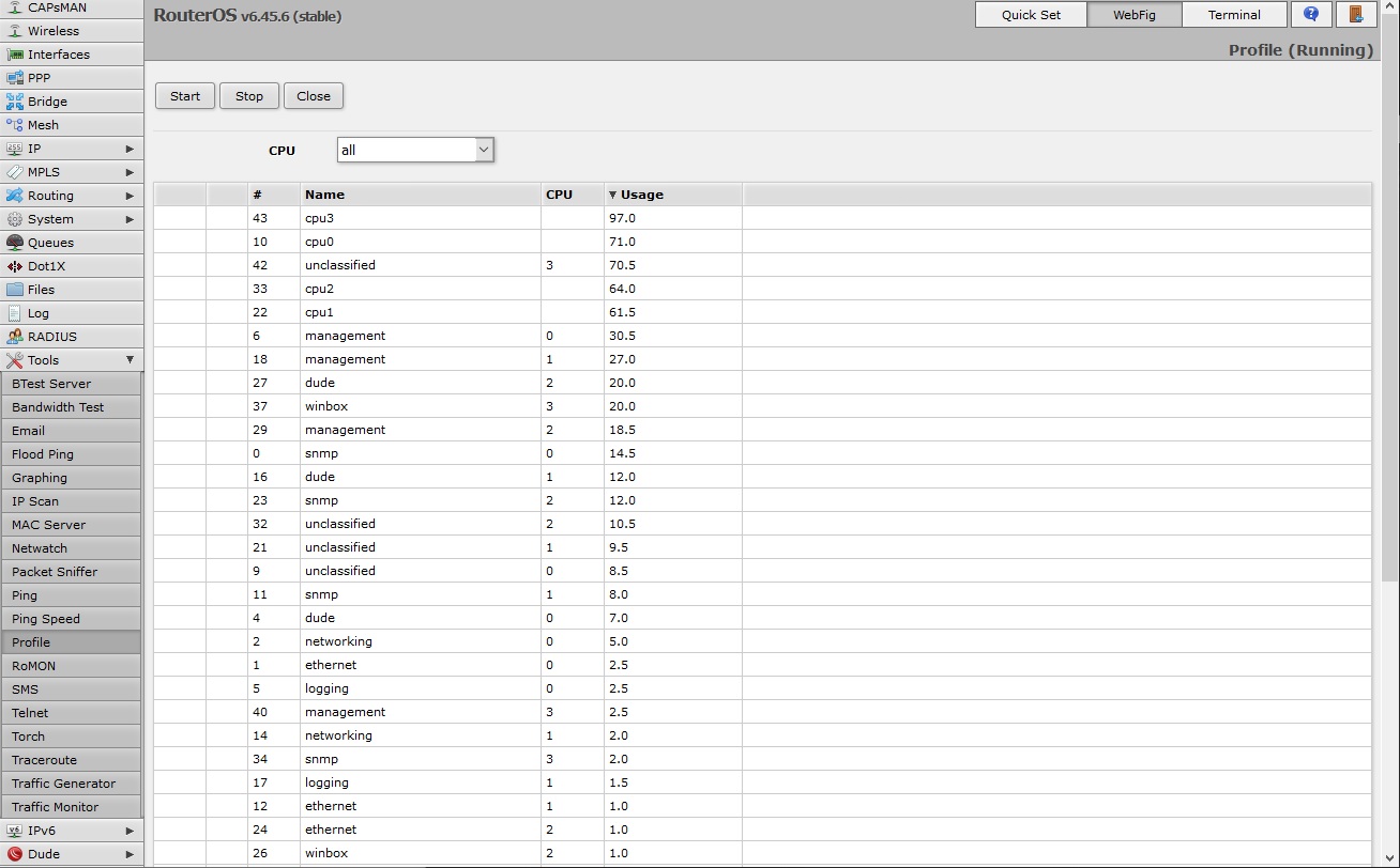

Our dude also locks up generally at least once a day. and winbox doesn’t work. However, webfig does. It locked up a few minutes ago, and I was able to webfig in, do a profile, and make a supout, which I’m sending to support and referencing this thread.
There are 2762 items listed when I look at “Services”

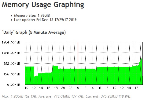

There is also a spike in memory usage (unless that was due to making the supout, which took several minutes):
