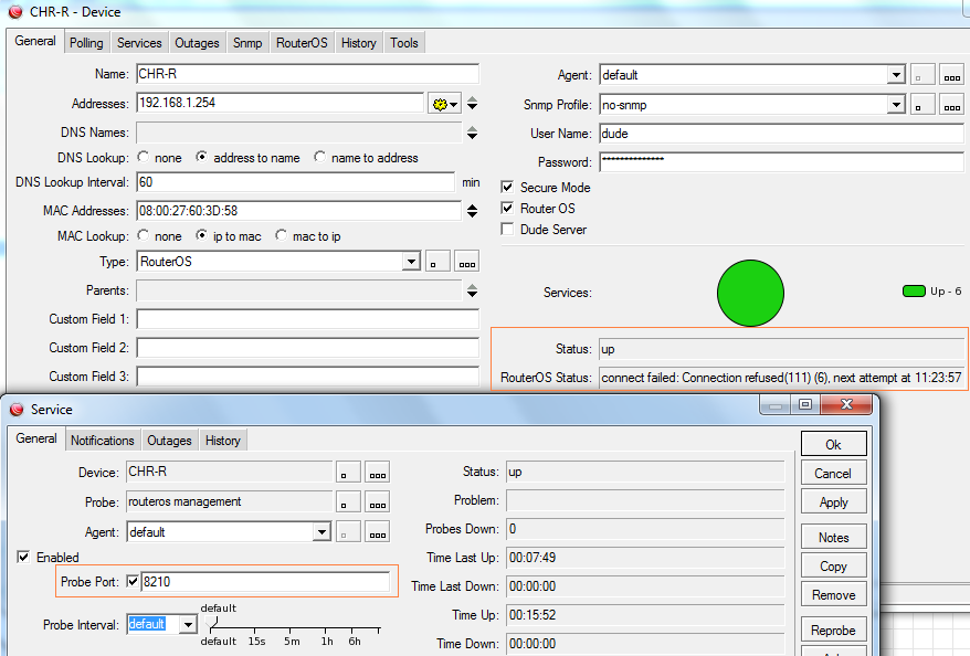

i will try to manage my mikrotik device via “The Dude v6.39.3” . during my network discover i have edited the probe “routeros management” changin it with the my default winbox port “20891” and not “8291”. All the device are collected, but i can’t accesso on it via Dude…
How i can change the default RouterOS port on Dude Device?

In my test environment I had recently an issue with ROS devices with non-default Winbox port and reported it to the support:
[Ticket#2018010322001999] RE: Dude v6 - ROS with custom Winbox port - Dude hangs issue
https://www.youtube.com/watch?v=fWp1eH9CU2s
https://www.youtube.com/watch?v=_coYAsJlIPU
[Ticket#2018010322002603] RE: Dude v6 - ROS device with custom Winbox port - Connection issue
https://www.youtube.com/watch?v=WrNOou0js7s
Support replied that on RB hardware it working fine and service may be added. I can’t verify it because have only CHRs on Virtual machines.
If you experience similar issue - please report it to the support in order to help them to solve it.
Re-verified now and see that service status is up (green) but: RouterOS Status: connect failed: Connection refused(111) (6), next attempt at 11:23:57
