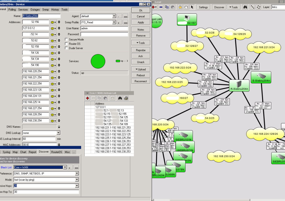

I have a problem with the main map. The core router is discovered with snmp and the item itself is absolutely correct. As you can see in the Screenshot, all vlans and networks has been found (the gateways are all on the left side of the device view).
Most of these networks appear at the map you can see on the right side. But, for example, there is not network cloud for 192.168.227.0
228 & 230 are missing too. The used Address-List blocks only the devices in the networks. I dont’t understand why the network itself (192.168.227.0) is not shown at the map.
I manually created a cloud with .230.0, but it will not automatically connect.
I attached the discover options because of the options for “recursive hops” and “Biggest Network Size Allow Hop to”. Even if I don’t think these settings are relevant.
Can anybody help me? I can’t see the error in my configuration.

Tom

you can just add link from cloud you created with switch.
If I create a new map with an other blacklist, the missed networks and its content shows up normally.
