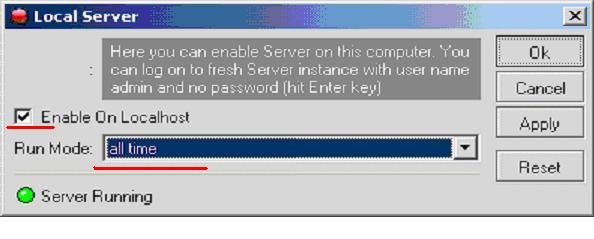

  4. Start it ones for first startup configuration.
    wine ~/.wine/drive_c/Program\ Files/Dude/dude.exe
    make sure you selected
