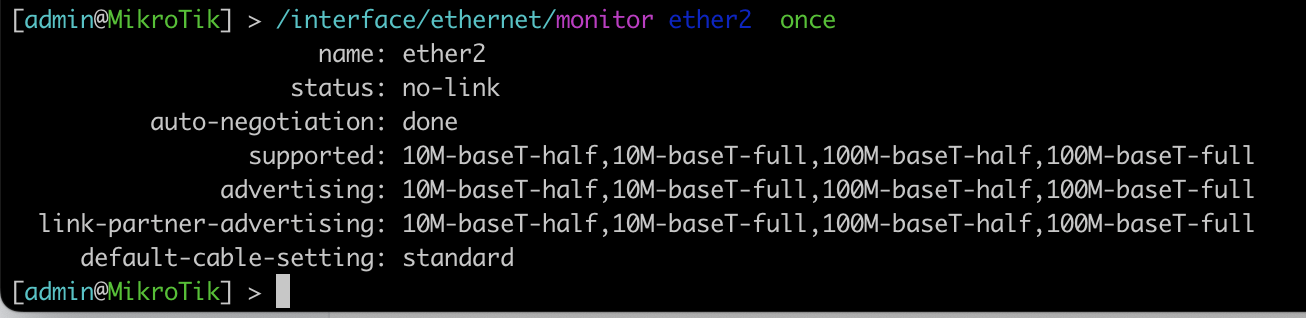

We probably may consider to use at least 3 sources for that
  1. SNMP - set a probe using SNMP in Dude
  2. ROS - set a probe using a ROS script in Dude
  3. Logs - Send logs to external Syslog and then notifications about specific event

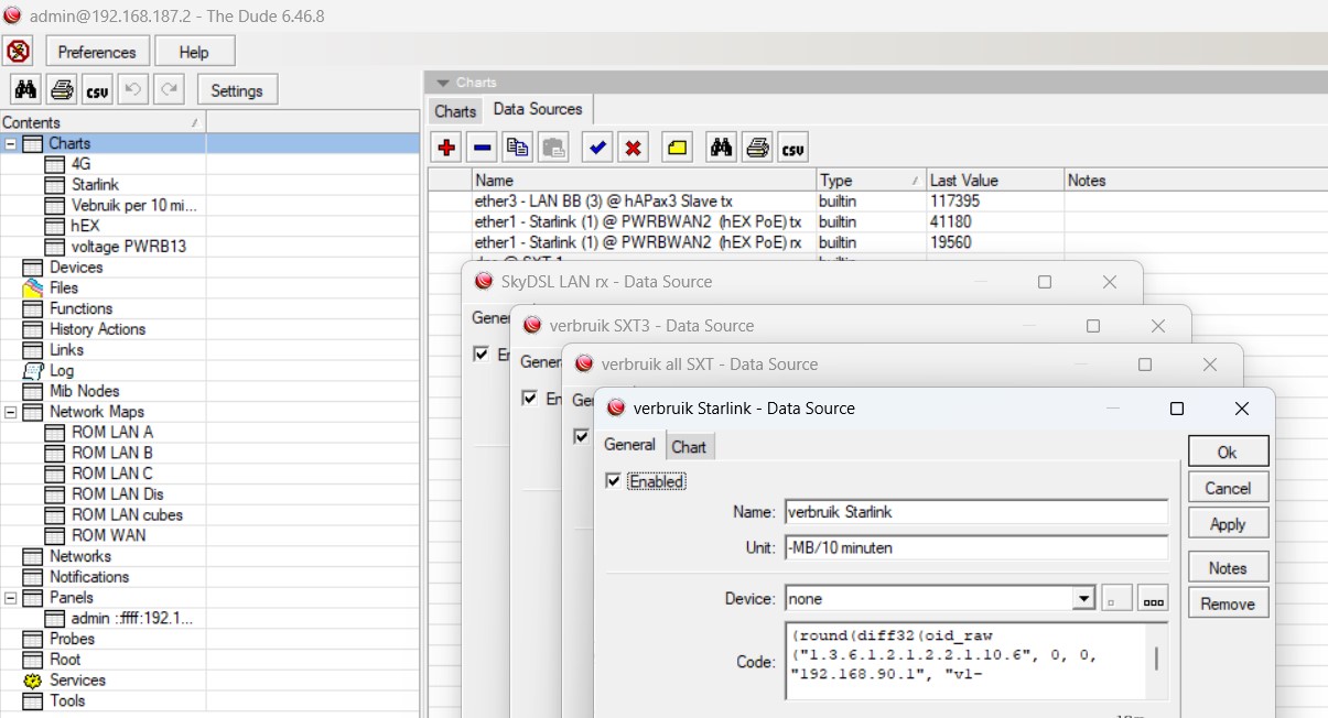

And … in DUDE you can create datasets, that will collect (and compress over time) the collected data.
Datasets are made with SNMP OID and some functions in DUDE to round-subtract-average-convert the collected data.
I have no exemple for up-down collection (that is in the DUDE syslog as LOG records) , but follow traffic that way.
eg code like :
(round(diff32(oid_raw("1.3.6.1.2.1.2.2.1.10.6", 0, 0, "192.168.90.1", "v1-public")))+round(diff32(oid_raw("1.3.6.1.2.1.2.2.1.16.6", 0, 0, "192.168.90.1", "v1-public"))))/1000000

One thing to note: Dude works by polling… so it records an instantance reading of something. It does NOT do “traps” or events… so its may not capture if up/down perfectly, but close (and closer if you shorten the polling intervals).
This polling usually happens via probes on a device, which also create “data sources”. But you can “shortcut” the probe, by directly using the data sources as @bpwl shows
While you can also send logs from RouterOS device via Dude’s syslog server – which save the logs, but it does NOT let you query/alarm logs.
Local logging → action “remote” ->Dude syslog → ROS logging as topic “dude” → logging action “e-mail”
Long difficult path for push notifications. Logging will be there. But no SNMP trap handler in DUDE. Need something else to handle the SNMP trap sent when interface changes state.
