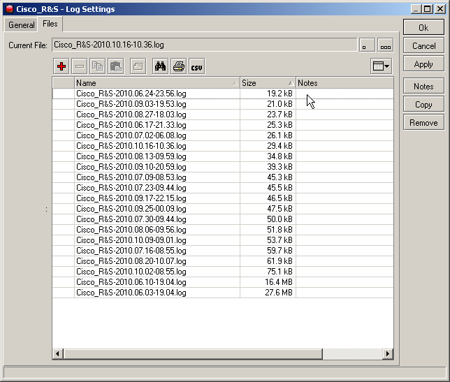

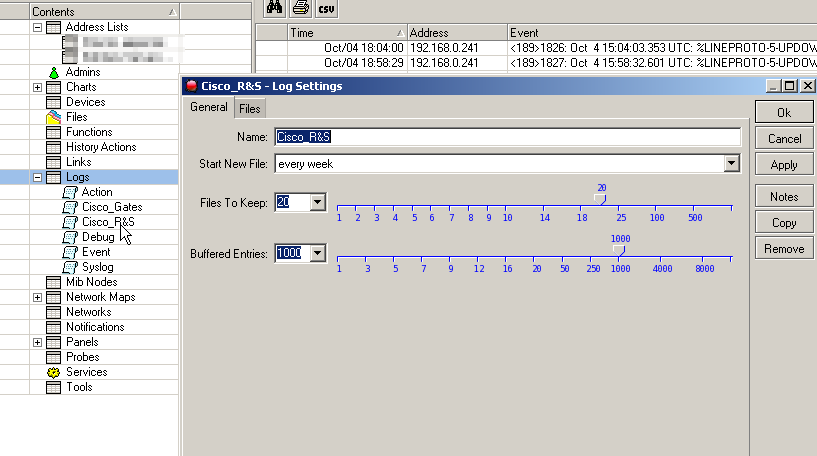

  1. Post your Dude version. I had no such a problems on 3.6 and 4.0. What version do you use?
  2. Files, you define to store syslog messages, are stored on server filesystem. Check C:\Program Files\Dude\data\files to find if there are in.
  3. May be you should specify rotation method for this files. Look at the scrinshots, it’s working config, dude server was restarted many times and files are persistent during changing version from 3.6 → 4.0Beta1 → 4.0Beta2.

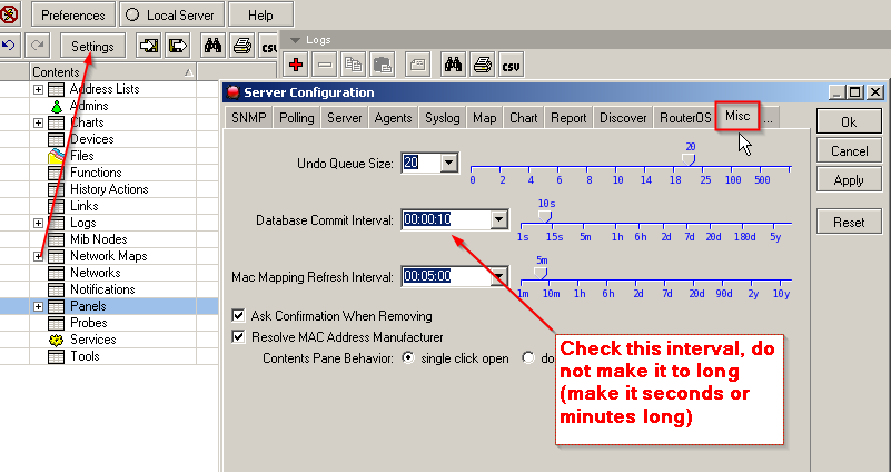

Not sure, but it seems your changes are not commited in The Dude database.
Check your database commit interval.

just checked the settings in the"Misc" tab.
Should be as default and equal to your setting
