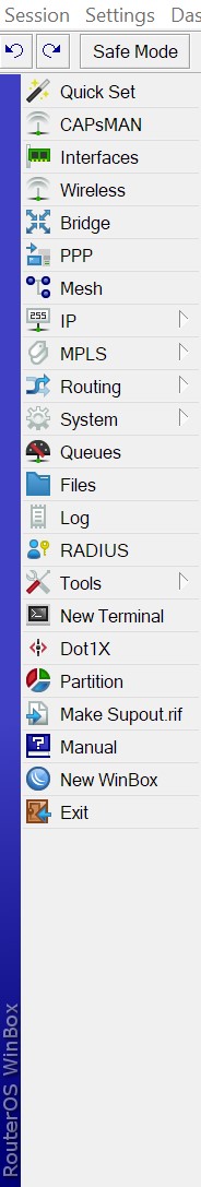

What do you see on the main menu with Winbox?
Attached a screenshot of the main menu.
I think the CCR2004-1G-12S + 2XS does not support the dude.
It looks like the dude server was introduced with version 6.47.0 for arm64 (CCR2004). I can’t see any indication, why it shouldn’t be supported. So if I didn’t do anything wrong, I’ll have to open a ticket then.
