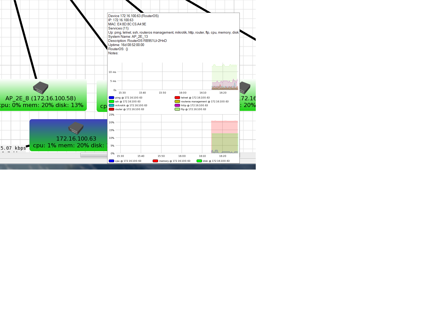

I have problem on Dude 6.40.1. A select “Device Name Preference” on Discovery to “SNMP,IP”. After discovery in field name of device it is ip address, not snmp sysname.
But at the same time I see it in the description of the device (image in attache)
