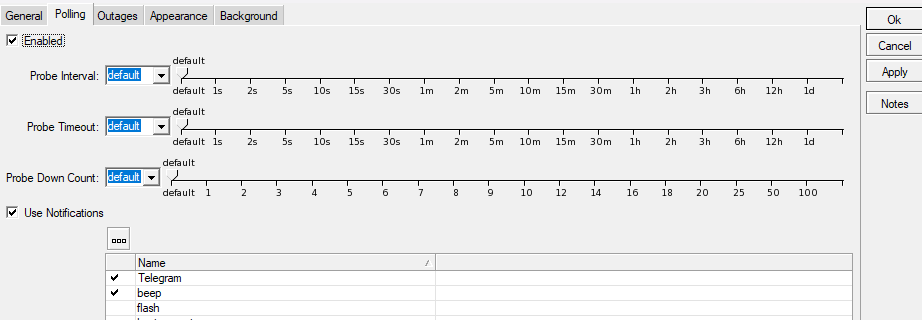

hi friend, still not working for me, from notification settings test button sends ok, but when it's supposed to notify about a network element being down, the alert doesn't send.
my notification in dude settings:
executing script from console failed, please check it manually
(dude-notify) failure: Fetch failed with status 400 (/tool/fetch; line 2)
