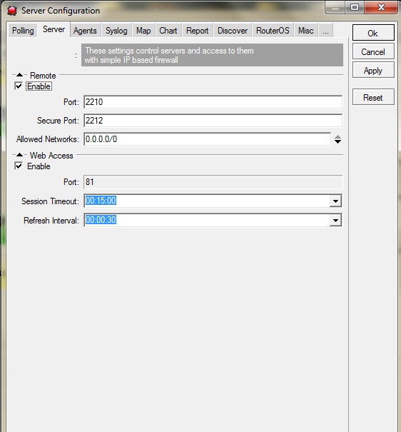

I installed the "Dude V3.6 on my RB1100 V5.7 everything works well i can connect by Dude client but i cannot access by web
From some reason in the Dude client> settings> server tab>
Web access is checked but on port 81 (Greyd out so i cannot change it)
Any ideas/ help ?

Hi thanks for the reply.
My server settings are attached in a jpg file.
On any browser i tried http://192.168.10.1:81 (I tried all the ethers IP’s as well)
