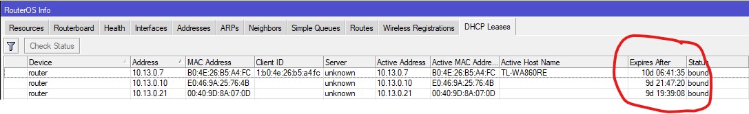

When looking at the DCHP leases with WinBox from a dude enabled router (Dude → RouterOS Info window), DCHP leases seem to have an extra 7 days in the ‘Expire After’ column. Pictures attached.
All devices running 6.49 (including dude)

I just noticed the difference too, in my case is it about 40minutes …
For now I can not explain why this is happening

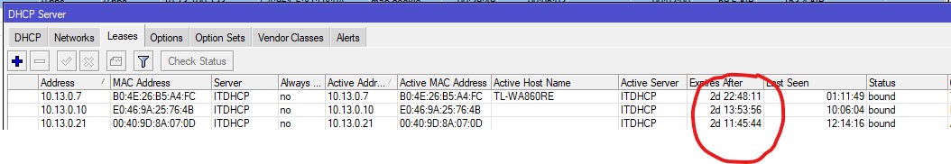

it is not winbox, that is just a display platform.
the values direct on the dhcp server are correct.
the values seen on the dude are pulled from the server thru api calls.
OR the api calls are not functioning correct,
OR the handling inside dude are incorrect
