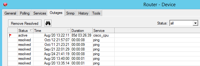

Dude have an Outages tab, where we may see:
Status: Outage state
Time: When the outage start
Duration: How long does outage is last
Service: Failed service
By using this information we should be aware about polling settings: Probe Interval, Probe Timeout, Probe Down Count

In such case, Duration we see under Outages tab shown us only service down time which depends on Polling settings.
