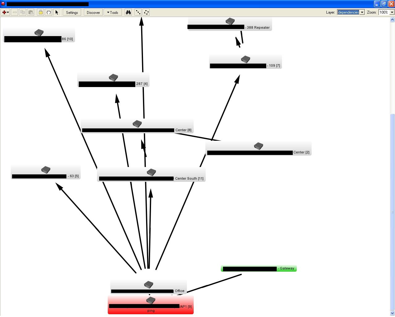

Which Dude version is that? v4? It would be nice to see your map with the dependency layer turned on, when the parent is failed.
It’s Dude version 3.6. I will try to get a screen shot next time this happens. In some cases the parent is on a different map though.

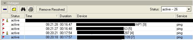

I have attached images of our outage list and the map that the issue is currently occurring on.
As you can see, although the parent is down, some of the individual devices still show up in the outage list.
