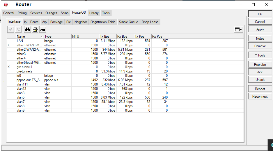

I noticed something strange on my Dude NMS.

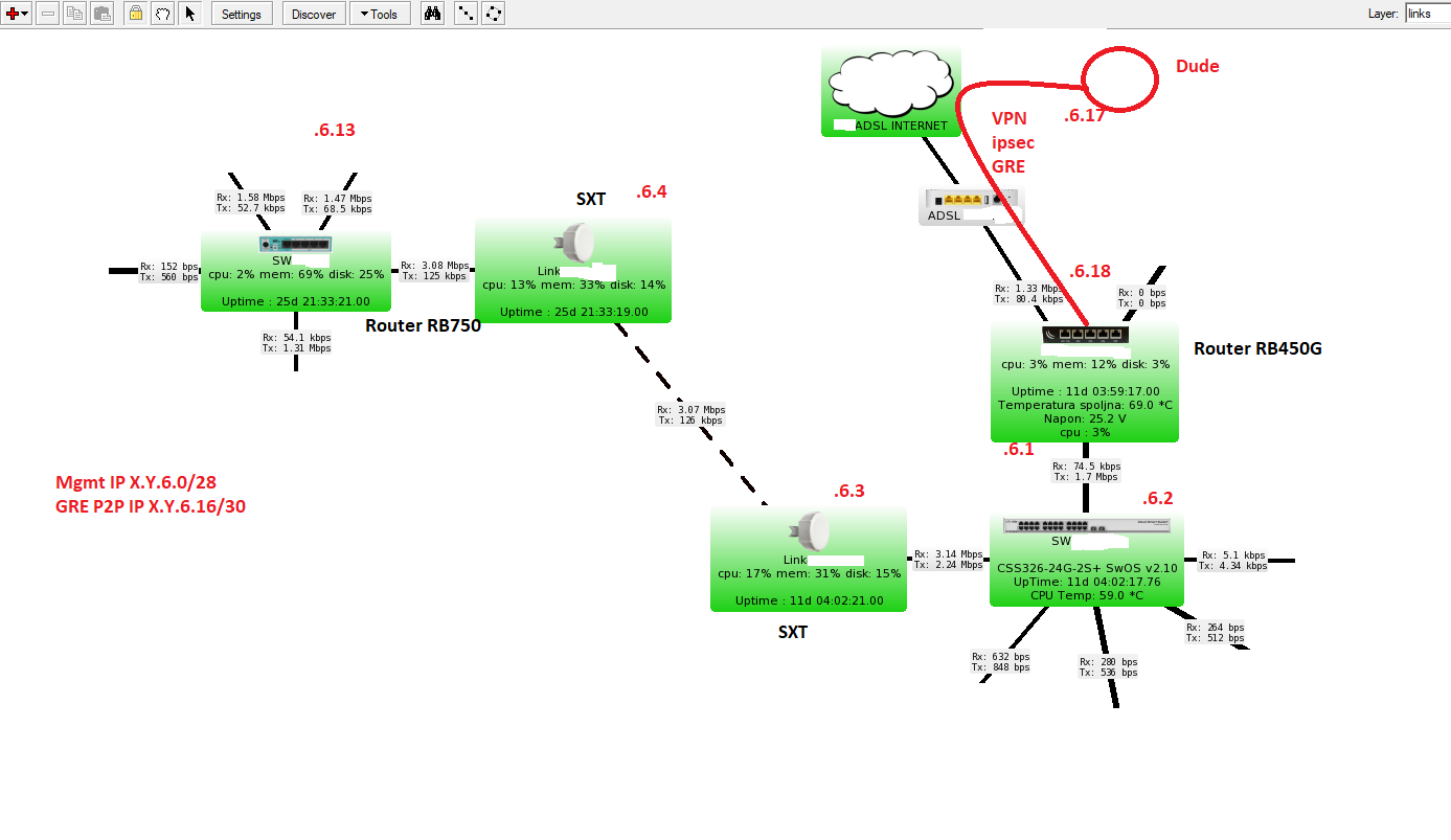

Here is my map:
Router is connected to Dude by ipsec gre vpn as p2p ip connection.
Other devices SW, p2p link and second router named SW are also mikrotik devices.
I found that snmp information was OK on all devices, but i find also that RouterOS info was wrong. All devices behind Router displays same information as Router.
As example i will show you on pictures below.

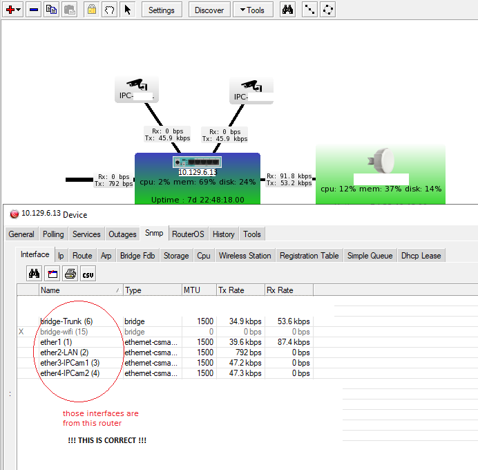

On main Router snmp details and routeros details are the same, as it should be.I illustrate showing you tab interfaces.
SNMP detail of main router
ROS detail of main router

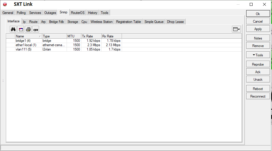

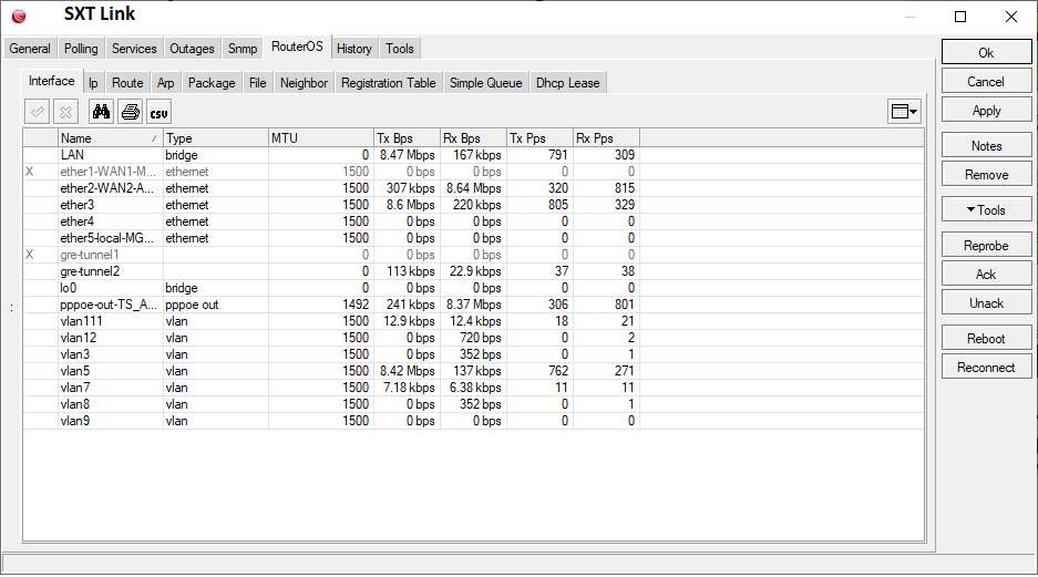

But, on the all other devices snmp details was as it should be related to that specific device, while the routeros details was wrong in the sense that they are showing info about Main router
SNMP detail of SXT1 p2p Link
ROS detail of SXT1 p2p Link
This situation was for all mikrotik devices on this specific map.
To access to devices Dude uses same credential username and password, and that user was in specific group read, winbox, dude.
NOTE: On same Dude server i have another maps and only here i found this problem.

If you use “Tools” (right hand side menu in your screenshots) and use “Terminal”, are you connecting to the correct Mikrotik device from DUDE?
Unfortunately this may be a different connection than DUDE/Winbox. I know no equivalent way to do exactly that from DUDE. So using “Reconnect” and following the ‘RouterOS status’ “connecting” and “OK” , in the ‘General’ tab is then the one suggestion I have.
Thanks for your suggestion.

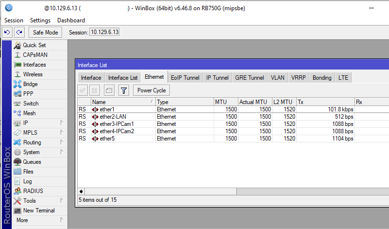

If i try to use tools/winbox it connects to right device. E.g. device with ip 10.129.6.13. But RouterOS tab on Dude still showing wrong interfaces and details
Here are the screenshots
The lower set of tools (Telnet,Web,FTP,Dude) start from your computer, the upper part of the list starts from the DUDE server.
If you added winbox, then that also will start from your computer. You want to test starting from the DUDE server.
Thank you for suggestion. Try that also but i can access to every devices from dude using ssh.
Still cannot figured out what is the problem.
